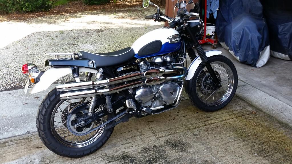

Try using those EMGO angle pipes made for the Bonnies. That's what I did when I put the Emgo shorties on. You might like the result, they are cheap at like $39 I believe. Gets the angle pretty good IMO.
Pic of my setup.
