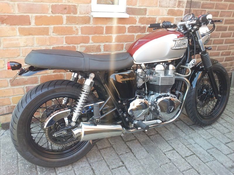

Just my $.02, but unless you're planning on a cafe or street tracker type solo seat, don't do a FEK because with a dual seat your bike will look all FEKKED up.
I went to a Thruxton rear fender to "streamline" my Bonneville a bit.
Still looking for a silver Thruxton/Scrambler front fender.

You can pretty easily make your own fender eliminator using aluminum plate. Easy to cut and bend. Patterns are available online, but it's not complicated to figure out without a pattern. I did it and used a tiny Acerbis taillight that's nearly invisible when the bike is off.
I like the idea of bobbing the stock fenders. Very easy to do with masking tape and a reciprocating saw. I used car door edging around the rough edges, but you could sand and paint them just as well.
