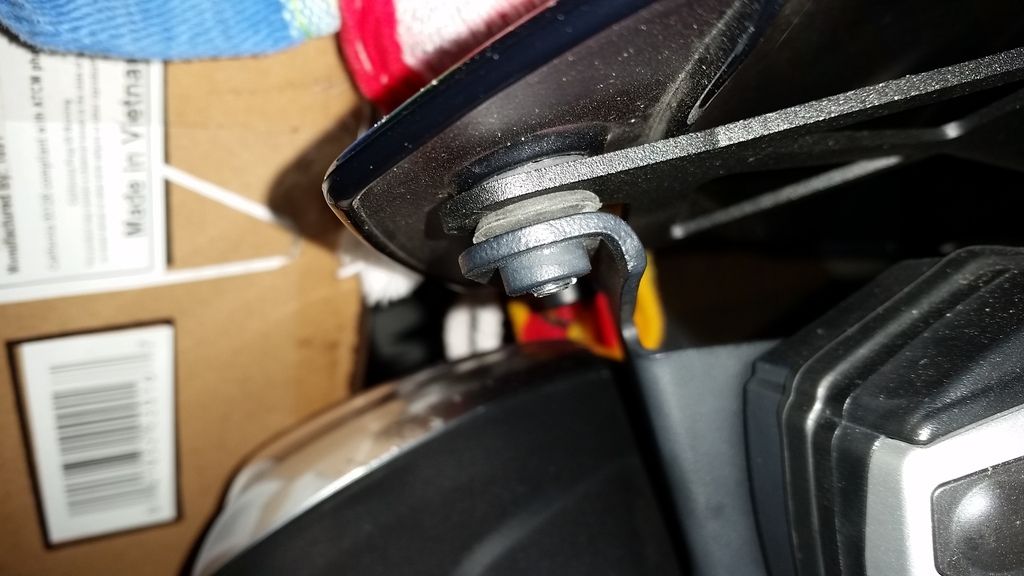

Just installed Darta Manta yesterday and took some pics to compare it with OEM screen. Hope this will help someone decide between the two in the future.

Dart Manta:
  • Significantly bigger than OEM screen. Provides some wind protection. If you are 6' tall (like me), wind will hit you in the upper chest area.
  • Clearly designed as a generic screen to be used on bunch of different bikes. Doesn't look as nice as OEM on the bike.
  • Fit and finish is not as good as OEM. OEM fly screen hides all the cables under it. On Manta you can see cables behind the fly screen.
  • Plastic feels cheap. I just installed it, so I can't tell you how well this will hold in the future, but compared to OEM it just feels cheap.
  • Finally, the biggest flaw in Manta is that it touches the front brake lever on R model when handle is completely turned to the left.
In the picture below, I set lever to its lowest setting (6) and pushed it as far right on the handlebar as I could, but it still touched the flyscreen. I could hear the click on front brake before I moved it down to 6th (lowest) setting. If it accidentally hits the brake, this could be a safety issue. I plan to reach out to Dart on this and see what they say.
