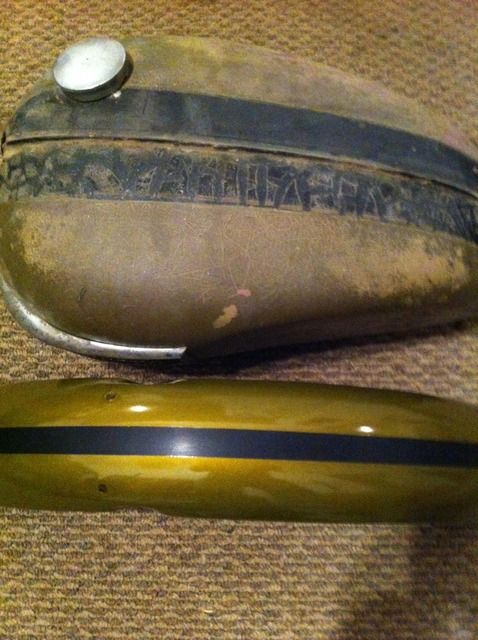

I have been researching paint codes for old Triumph colours. The proper codes seem to be as elusive as the holy grail. A mysterious shround of secrecy seems to surround them. I certainly understand why, as there are some talented folks out there making a living at recreating these cool old colours properly. Regretabley, I've read that we can't import these paints to Canada for some reason. Therefore, I have been bumming around on the web trying to find something I like that's Triumph Spring Gold"ish". I think I found something that will work, as my T100S is and will be far for a bone stock bike.
Dodge has a cool green/gold from way back called GF3 Amber Sherwood Green that looks like it's in the same ballpark.
What are the odds someone here has had a go at that colour before?
Was considering it, with a black stripe down the spine of the tank, with gold pinstripes, which i believe is the paint scheme from the 1970 Triumph TR6 Trophy?

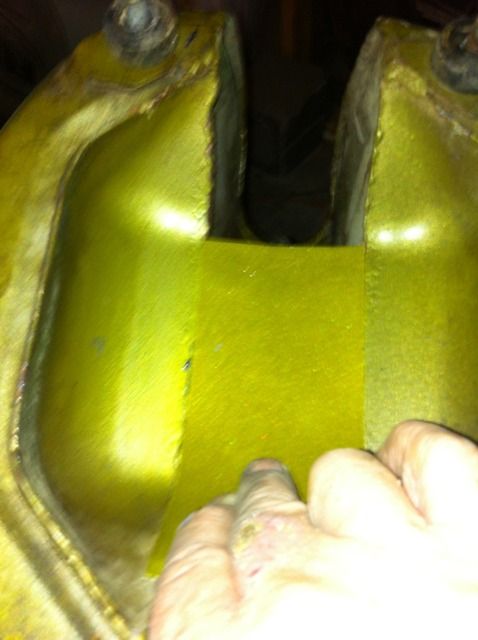

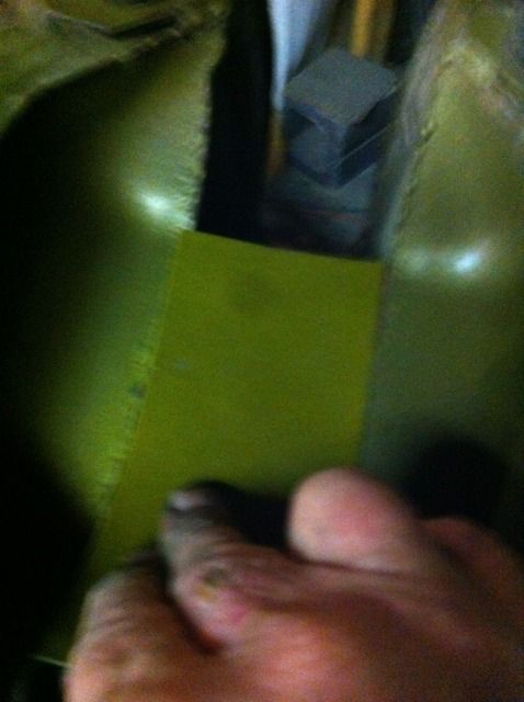

Here's a couple of shots of the Jeep Rescue Green against the underside of the gas tank, with flash and without. This sample is spray right on bare aluminum. I'll shoot another sample over a black base and see if it darkens it at all. It is close enough that I am going to use it and you probably won't tell a difference unless you're parked right next to a fresh factory color. This can is a one step, I will buy it as a "base coat" when it's time to paint. the base formula is different than what goes in the can. The can is almost 50% clear that I think is not in the base coat expecting a clear top coat. This formula has:
Gold
Trans Yellow Oxide
Gold Mica
Jet Black
Green Mica
Super Red Mica
Blue Shade Green
Red Oxide
Drier
Clear
These are 4oz cans, it's cheaper to get the Mopar paid off EBay where you get 5oz. for $17.75 shipped.
