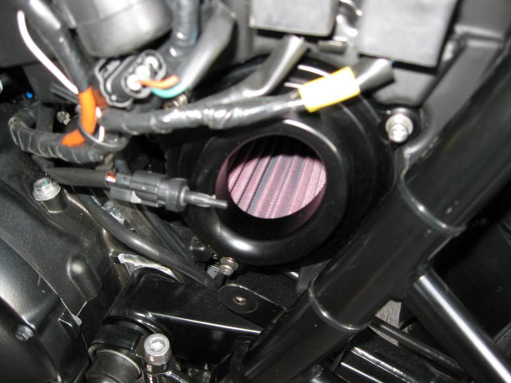

Adding a few more photos of a Street Twin snorkel removal. You can see the snorkel shape, and the inside of the airbox, which is baffled.
I haven't pulled the side covers off the T120 so visualizing the intake setup has been difficult until now. It looks like there is one snorkel under the left side cover and air is pulled from around the sides of the cover. I can't say what removing the snorkel or putting individual forward facing filters on each throttle body ($600 for 2 filters and 2 tubes????) would do in terms of lessening the restriction but for comparison, consider the Rocket. Here, the definition of snorkel is different. The air path is into a duct opening towards the back of the seat, through the seat duct, through a downward facing "snorkel" which fits over the airbox, through a single filter, and through a tube that comes out under the tank. This is fitted to a large plastic plenum that opens to three sections that fit over the three throttle bodies. The intake air temperature sensor fits into this plenum. This is the definition of restrictive. Changing the single filter in the airbox to a high flow Triumph or K&N filter did nothing. Ripping the plenum off and placing a K&N filter directly over each throttle body made a big difference in conjunction with a performance exhaust and a proper tune.
