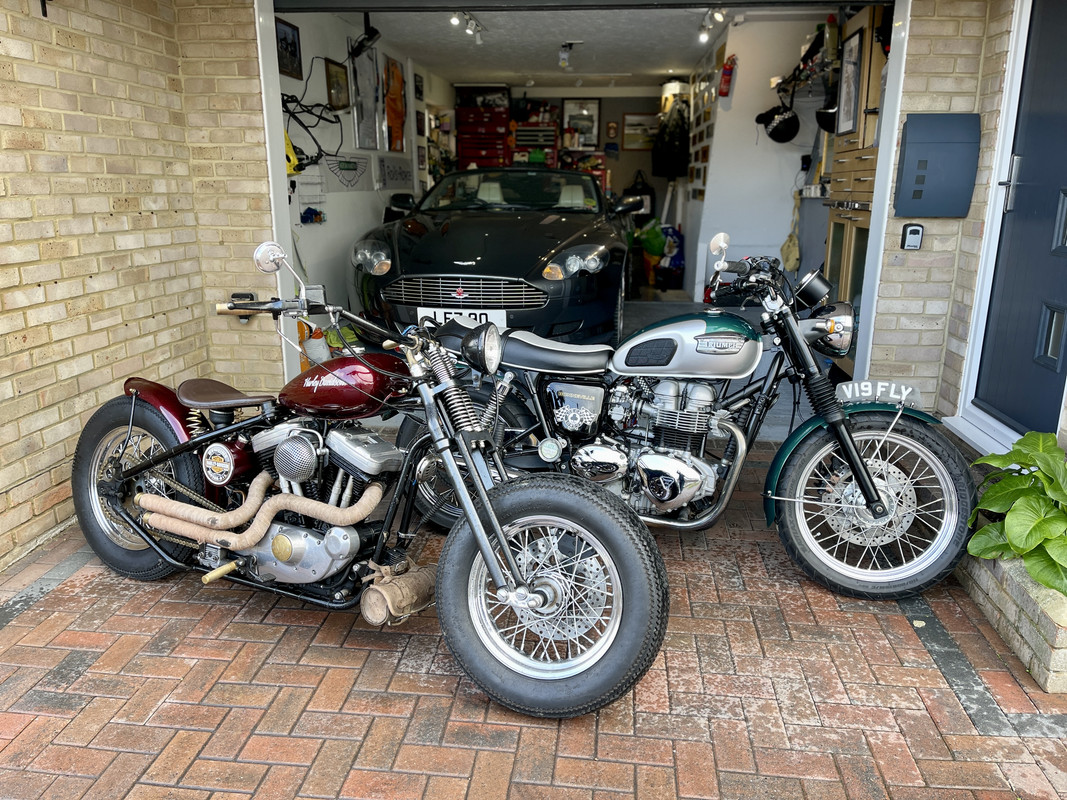

I've just brought a Quad Lock for my Bonnie, and my pal has told me to buy the vibration dampener as they can kill your phone's camera.
I've ordered it, but I'm now worried as I've read a few articles on this.
Anyone else has iPhone issues when using a quad lock, or does the dampener fix the problem?
I've got an iPhone 12 Pro Max.
The photo is pre-dampener.
