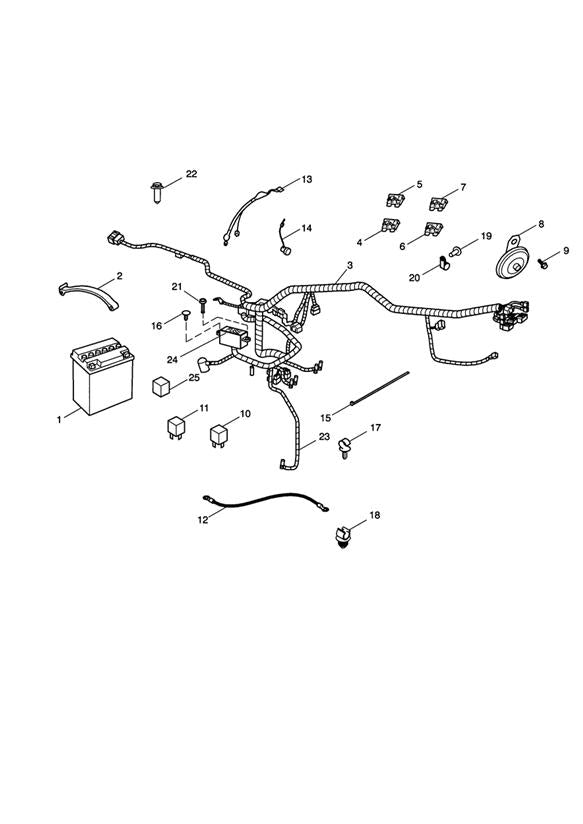

#12 ·
On my bike, a 2008 America EFI, its a pain, because its mounted under the tank, on the frame spine, just above the engine, and I have to lift the tank to get at it - same on the Speedmaster. On other models its located in or near a side panel, nearer the solenoid I think - much easier to get at. The relay itself is just a blue plastic cube (maybe a different colour on your bike) easy to pull out of its socket, with 5 pins. The relay is an Omron G8HN-1C4T-RH but as I say that's the one on my bike - earlier or later models may have used parts sourced from different manufacturers, but I think the actual relay itself conforms to an an auto industry standard configuration as far as pin layout and size goes - so different makes are interchangeable. BTW, I'm working on a simplified and easy to understand diagram of the starting system electrics, which I'll post soon. Electrics are pretty easy for me because I've been in the industry for many years, but not all of us have - having said that, even I sometimes have difficulty tracing an automotive circuit, they can be a bit confusing ...... watch this space ....
This may help ......
