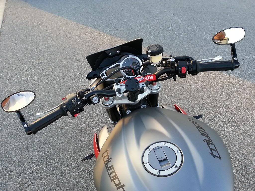

I installed them yesterday. It is not as hard as it seems to get the cables out of the holes. I used a very small Allen key(any other stiff hook formed thing will work), taped the plugs together with a tiny piece of tape and used the hook through the holes where the switch assembly sits to prod the cables out of the handlebar.
The grips work pretty good and actually look better than the aftermarket solutions I checked, because most of the wires are tucked away nicely, and installing the electrical connection is just plug and play.

Congrats on a job done. If you've never had them before, you'll find them indispensable. I used to poo-poo heated anything - until I tried it. I'm currently in the process of redoing my grips. I'll post some more pictures in a few days that add more detail to the pics I've already posted above. The latest alterations were necessitated by a non-working throttle side heater. :(
