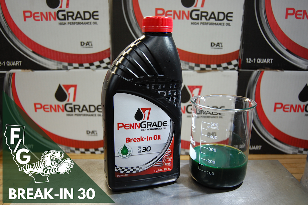

I highly recommend Lucas 20w50 Break In oil You may have to order it directly. 8$/quart
Is this what you have in mind:
Ask for Dan
Both these are way more reasonable than what i found - now to find out who can deliver the quickest! Thanks!
Ask for Dan
#7 ·
30w might be okay in cool weather, but 20w/50 will give better heat protection and new rebuilt engines generate a lot of heat.
