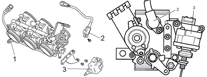

On the Daytona 600 and 650 the Secondary TPS and Secondary Stepper Motor are located together at the right hand end of the throttle body assembly. The Primary TPS is also located at the right hand end of the throttle body assembly – just below the secondary sensor. The second throttle is the upper one so the Secondary TPS will be on the end of the upper throttle spindle while the Primary TPS aligns with the lower throttle spindle. To aid identification Triumph fitted a white connector to the Secondary TPS whereas the wires for the Primary TPS have a black connector. The Primary Stepper Motor is on left end of throttle bodies.
Location of Components - Rocket III
  1. Primary TPS
  2. Secondary TPS
  3. Primary Stepper Motor
On the Rocket III the Secondary TPS is at the front end of the throttle body assembly while the Secondary Stepper Motor is located between throttle bodies for No. 1 & No. 2 Cylinders. The Primary TPS is mounted on the rear end of the throttle body assembly aligned with the lower throttle spindle. The Primary Stepper Motor is located at the front end of throttle bodies alongside the Secondary TPS. The Primary TPS can also be identified by its shorter cable.

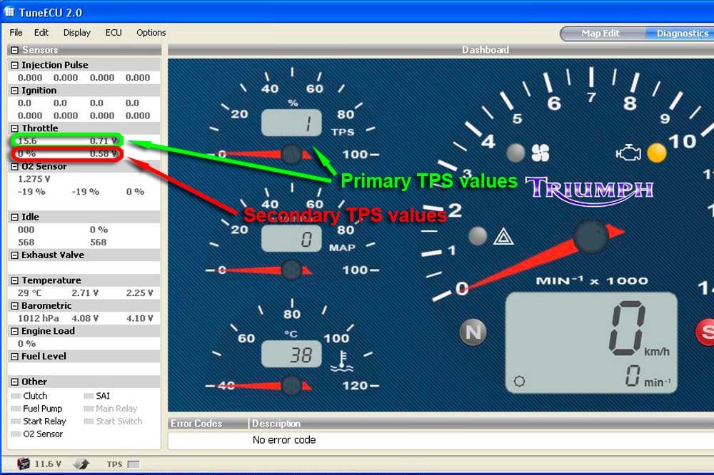

When the ignition is switched on the secondary throttle is moved to the closed position. With TuneECU connected select the "2nd Throttle" command on the "Tests" page. This will cycle the Secondary Stepper through its full range from closed to open and back to the closed position. This test is to verify correct operation of the Secondary TPS through its full range of operation.
With the Secondary TPS in the closed position we can check the voltage. Now here’s an important difference from the information I gave earlier. The secondary TPS voltage is not displayed on the dashboard on the “Tests” page the way the Primary TPS voltage was (as illustrated earlier). To see Secondary TPS voltage we look in the “Sensors” column on the left of the “Diagnostics” page. Under the label “Throttle” values for throttle position % and voltage will be displayed with the 2nd line showing readings for the second throttle, as highlighted below
(thanks to Dazz84 for the screenshot).
The factory manual includes a recommendation for checking secondary TPS voltage. A note says "To ensure the second throttle is totally closed, have an assistant manually press the butterfly closed." The secondary throttle is the upper one so it’s easy to access the butterfly (throttle valve) with the airbox removed. If necessary adjust to 0.60V (+/- 0.02V) by rotating the Secondary Throttle Position Sensor. On the D600 & D650 it’s the one with the white connector, on the Rocket III it’s the one with the longer cable. Make sure you re-check the voltage after re-tightening the screws because it's very sensitive.
