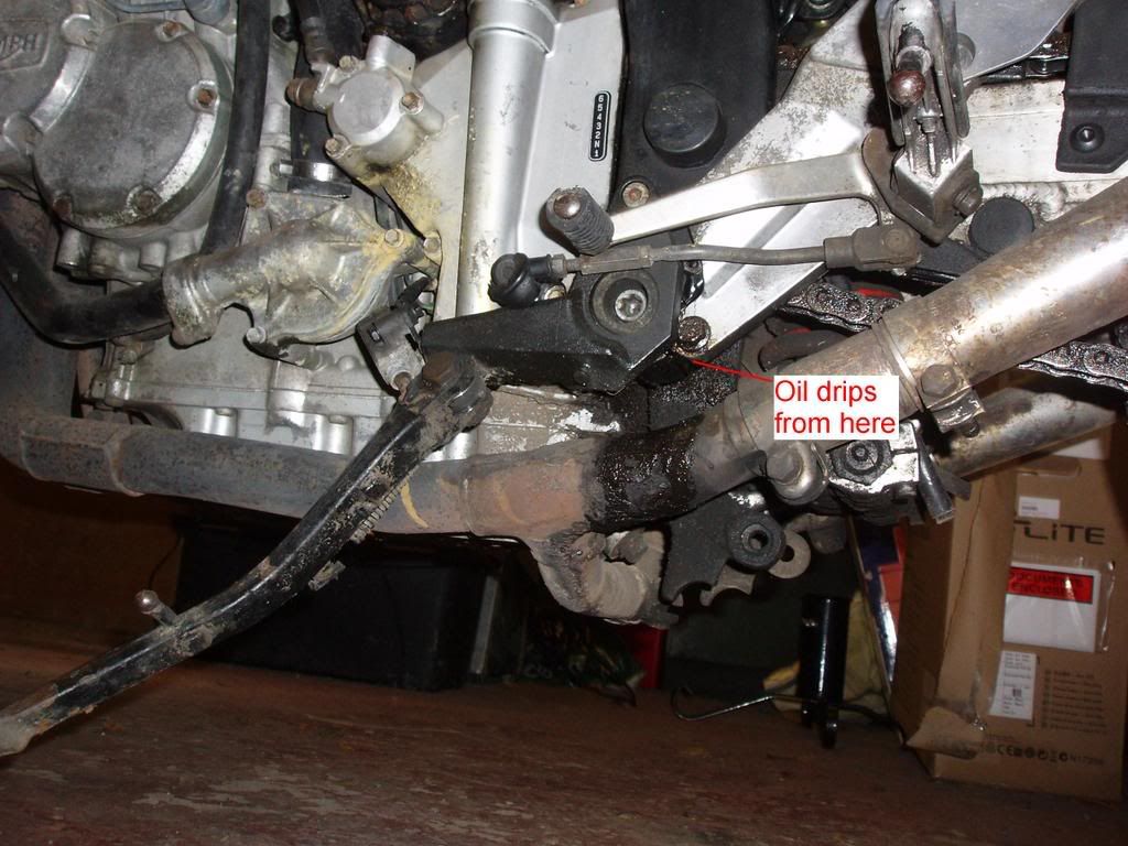

I posted about this some time ago, but concluded that the oil was coming from my Scotoiler. I removed it, but still have oil on the garage floor. It seems thick and black - could it be just over zealous oiling of the change, or have I got a leak from somewhere?
Hi screen, being so black and dirty looking I would hazard to say that it is dripping off the chain, although, I have been over zealous with the chain lube before but not had it drip off like that. I use the Motul stuff which is really sticky.
If it were a leak, I would go for the gear selector shaft oil seal. Have you changed the chain and sprockets lately? If so, did you change the oil seal?
Thanks Roden. The engine oil is new and clean in the bike, but this is really dirty. I guess that could be the crap it picks up on the way though. The oil level is down on the min mark, and I don't think I've done enough miles for the motor to have burnt it, so that points to a leak.
I've never had the chain off.
Is the gear selector shaft oil seal replacement an easy job?
Thinking about it a bit more and having had a look at my bike, if it were this seal the leak would be really visible. Just have a look see if it is from the gear shaft and maybe the oil is migrating back.
The other place could be the counter shaft oil seal, although I haven't of anyone having this trouble.
If it is the gear shaft seal, MotT3 has a really good description of this procedure on his website. If the chain and sprockets need doing, best to do them at the same time along with an oil change.
Maybe a good de-grease will help pinpoint the source of the leak?
the front sprocket cover has a gasket which may have failed.when a chain is changed, the oil has to be drained, as the cover also holds oil at the bas of the dipstick.if this gasket has failed, engine oil could be being lost into the front sprocket area where it is mixing with old chain lube and general grime, giving you this sticky black product, emerging from the front sprocket cover.
I've been a bit slap happy with the chain lube before and had it leaking out in just the same spot...I wouldn't worry too much..just monitor it for a while and see, it could just be as the bike gets hot more of the sludge is moving ?? On your next oil change you could always take a peak.
Thanks for all of your input. Having changed the oil not so long back, I don't really want to get involved with replacing it just yet, so I will go with your suggestion MOT.
