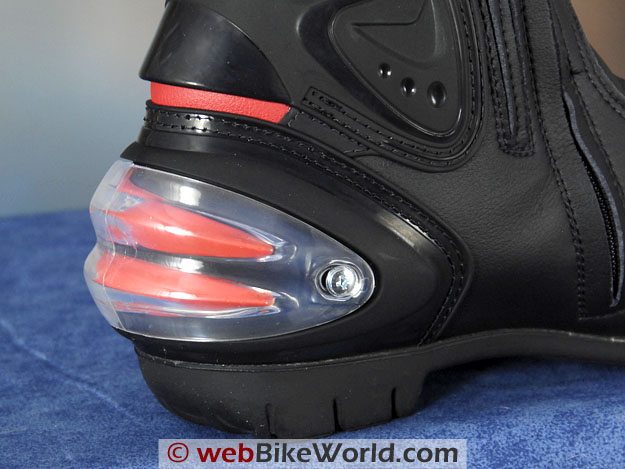

My wife also wears Sidi boots and the angle of the heel slopes in at an angle (must be a race thing) which made it difficult to get purchase on the little round knob to get the stand down.
