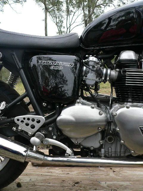

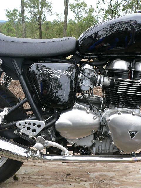

There seems to be allot of seat questions floating around so I thought that I would add my $0.02 AUD worth.
Just for interest sake I thought that I would post the difference between the standard OEM Thruxton seat (MY2005) compared to the Aftermarket Triumph Bonneville SE gel seat.
I bought the seat on Ebay with the idea that it would make a bit of difference for Leonie and getting her feet on to the ground flat footed.
It makes about 1.5-2 cm of height difference and according to my wife's seatofthepantsometer doesn't feel any different comfort wise.
The SE seat is more scalloped out but is on the same seat pan. The rear of the SE is not as narrow as the Thruxtons and (with a push) you might be able to get the cowl back on but you would still need the screw attachments as the SE seat doesn't have these.
OEM Thruxton Triumph Bonnie SE gel seat

Thanks guys, I knew that the information would be handy for someone at sometime along the way. Like most of it - it is not that important until you go to do the job and then go to research it. :)
