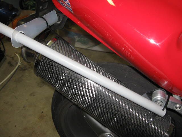

Proposed solution: mount a bar that runs from the muffler mount to the turn signal, thereby holding saddlebag away from the muffler, no matter how much I load it down, or how much the wind tries to move it. Here's the work in progress:

And here it is with the saddlebags in place:
Plenty of clearance! And I think I can set it up so the whole thing only needs a couple of zip ties to be held in place. The front is already pretty solid; I need to come up with a good setup for the back. What you see is just a piece of thin plastic I cut out to test the concept.
So help me out; what am I overlooking? Great idea, or should I hard delete this thread?

Hide,
It'll work just fine. Load it with some books after you've done everything you can think of, and modify it more if you have to. Wind is the only thing that might present a challenge. Takes some bungee cords just in case.

HiDesert, There looks to be a small tab at the bottom inside of the bag. Perhaps you can install one of those brass dough nut looking things used in leather working to make a place for a tie wrap.

What looks like a tab hanging down on the inside side of the bag is a foam pad, the better to absorb paint-polishing grit. :D
But now that you mention it, maybe I could put a donut in the strap you can see hanging down, and use that to zip tie the bag to the brace.

Mark I
... the last wan't even Mark 0, but what the heck.
You can't quite see it in this picture, but I filed grooves in the cross brace so the zip ties lay below the surface, and can't slip back and forth. The cross brace is cut down to a pin, which passes all the way through the piece that parallels the muffler. That whole end is packed with JB weld. Seems pretty solid. Here's the front end:
Thoughts?
