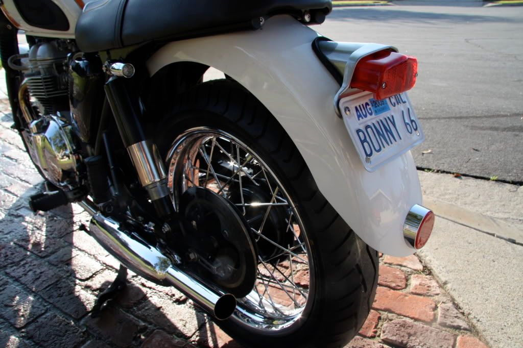

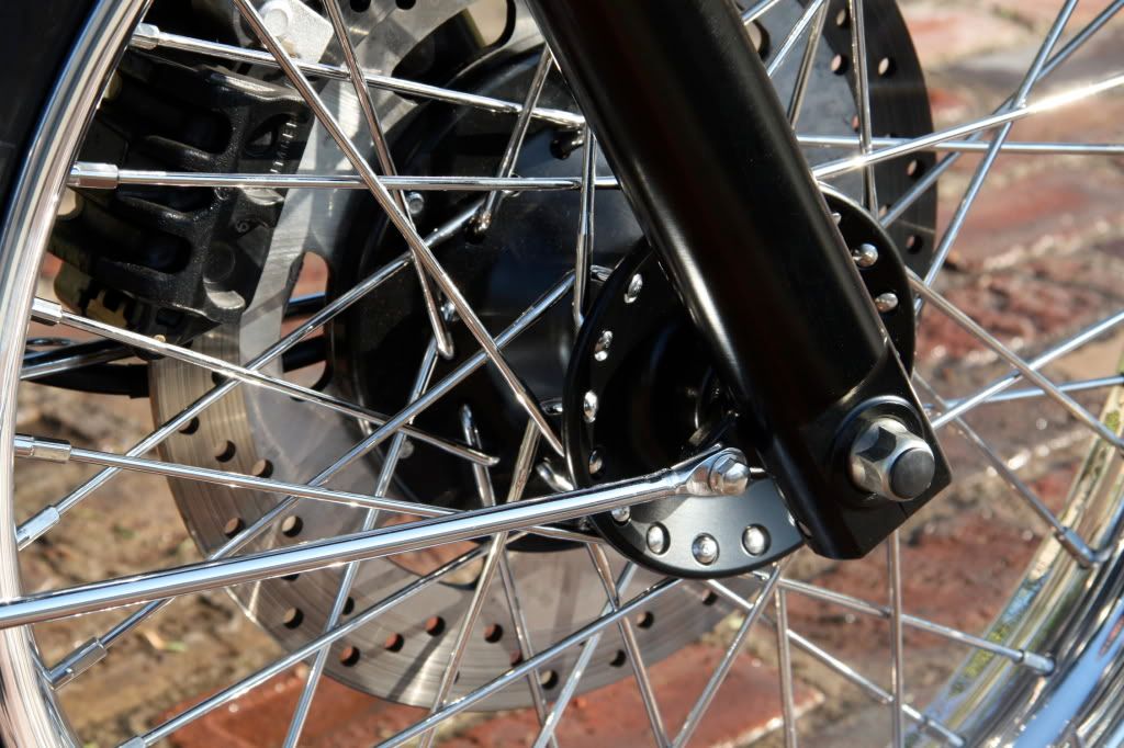

Here are a few pics of my new wheels. These are Sun aluminum rims manufactured by Buchanan's in Southern California. Buchanan offers these and Excel rims for essentially the same price, but after discussions with Kenny Buchanan I was convinced the Suns were the way to go. The spokes and nipples are polished stainless steel, but the wire gage is one size up from the stock Triumph steel spokes. The front rim is 2.75x19, the rear is 3.50x18. Going to an 18" rear wheel limits the tire selection, but by using a 140/70x18 I was able to keep the rolling diameter of the rear tire only 3/8" larger than the stock 130/80x17. The stock Bonneville center stand still works with this slightly larger rear tire, and I like the looks of the larger 18" wheel. While the wheels were apart I decided to powdercoat the front and rear hubs black to match the frame paint.

The 18 rear looks so much better IMHO that the 17. Just fills the area better.
Well done.

+1 on the 18" rear wheel, definitely fits the bike more.
Also, the black hubs are a subtle thing but they really look a whole lot better than the silver originals. Looking at your bike makes me think the hubs should have been painted black from the factory -- pretty sure they were black on the original 60's bikes.

The Sun's are manufactured by Buchanan from extrusion run to their proprietary specification and alloy. They roll them, weld the seam, stretch form them in a "circumpress" to within .015" concentricity and then CNC machine 100% of the surfaces to within .003" TIR. Buchanan drills them to specification at the perfect angle, machine and hand polishes the rims and then laces them to the hub. The Excels are 6-7% heavier, and allegedly not quite as resistant to getting banged up as the Suns. Buchanan sells both, and was happy to supply either one. I originally went looking for shouldered or flanged Akronts, but apparently the quality of Akront rims has declined a lot over the years and I couldn't get exactly the sizes I wanted - hence the Suns. I've done business with Buchanan's since 1966 and trust their recommendation. Buchanan's has a lot of experience repairing broken spokes on Triumph wheels, but claim that with the larger diameter stainless wire they used to manufacture my spokes I won't ever have problems
These wheels are about 3.5/4.0# F/R lighter than the stock steel Triumph rims - not a lot but enough to feel the difference since it is unsprung weight. I used bolt cutters to cut the spokes and free the hubs without dismounting the OEM rubber from the rims - it only took 10 minutes for both wheels and was weirdly therapeutic.
I was changing the rear tire on one of my '66 Bonnevilles when i held the tire up to my 2007 an decided it would look pretty good - the older bikes are 19" front and 18" rear - and yes, the sixties bikes had black painted hubs.

Great info and the final product looks amazing. I've been considering swapping to black anodized rims and getting the hubs PC'd black on my Thruxton. 3.5-4.0 pounds removed of unsprung weight removed must feel nice, although I'm not sure how much I'd save over the stock Thruxton rims.

I see that this thread is fairly old, but am wondering if dkreidel can shed some light on the impact the 18" wheel size has had on bike handling. I've read numerous threads and discussions on this. Some say anything other than the original size affects handling, others say it doesn't. I like the looks of the 18" as well, but am unsure I will do it if it affects handling. What sayeth thou?
3,885 Posts
I ran an 18" rear wheel this summer...no negative effects on handlling whatsoever and lighter than the stock 17" rim/tire combo. I recently switched to mags in order to go tubeless, but, had I stayed with spokes, I'd have kept the 18 incher and laced up an excel front wheel to match...
Wow - a really old thread!
I really couldn't tell any significant difference in handling that I can attribute to the 18" rear wheel as I switched from the lousy Metzlers to a good set of BT-45 'Stones at the same time.
I can tell quite a bit of handling difference on the Scrammy with 19" Suns front and rear; but again a tire change to Maxxis DTR rubber and Bonneville length rear shocks at the same time.
