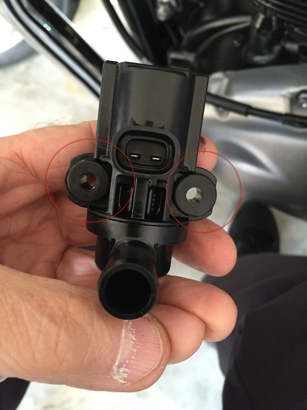

So I dove in last night, my first real stab at mods: removed the SAI system and installed the TTP plugs. Used the Delboy's Garage vid as a guide. One difference threw me (it doesn't take much): his bike (Scrambler?) had the solenoid fitted onto the same bracket as a coil (the solenoid slides onto plastic pegs). My T-100 has no sign of that coil in that spot -- just the solenoid, which, like him, I kept.
Does this mean I can scrap that entire solenoid, complete with the bracket? (I'll be doing the TTP retune to deactivate the warning light of course)

The TTP or TuneECU SAI delete facility will only cancel the engine check light feature that detects the solenoid and lights up if it's removed.
The solenoid will still be powered and will click away unless removed following software delete.
That's how I understood it. Thanks for a wording it much better than I did, Forchetto. So I assume I can remove that solenoid, bracket and all? And where's that Delboy-video coil, then, on my T-100? Further forward on the top frame rail, perhaps?

The scrambler in the video has two ignition coils, being a 270º engine, your T100 is a 360º engine and only has one coil.

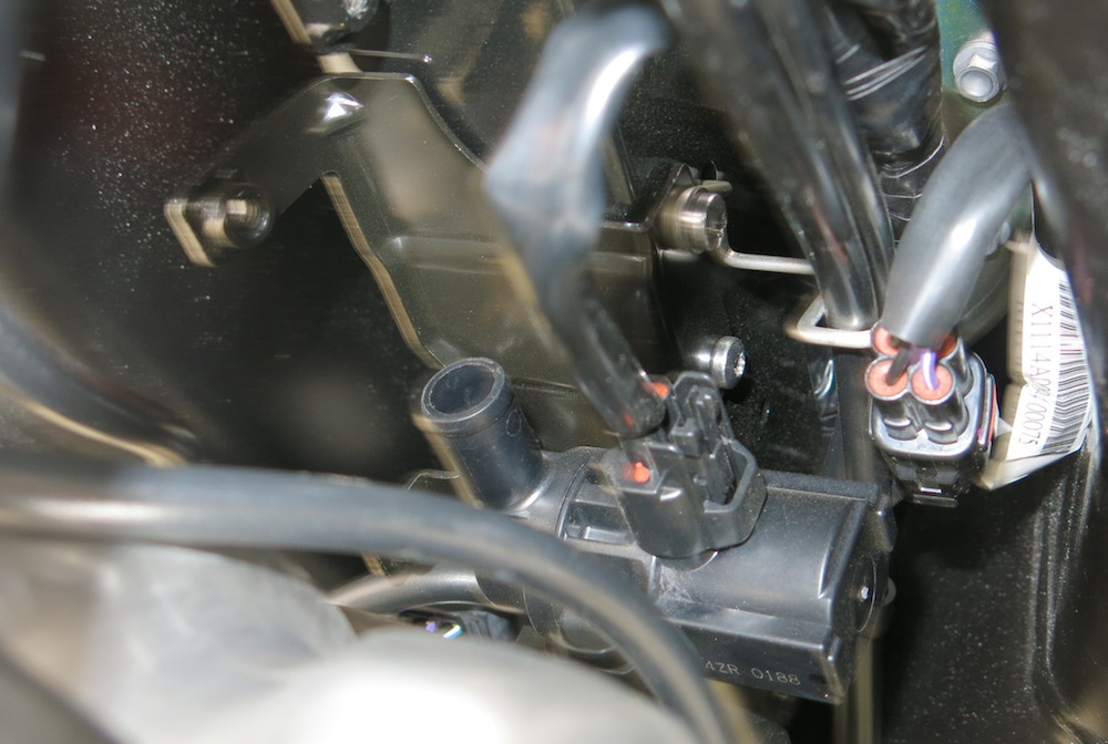

the holding systèm.just slipped.
to remove AI. just disconnect the AI connector. take care.fragile and tight.
I put a little w40. waited a little.shaken gently. pinched the clip. and it just comes

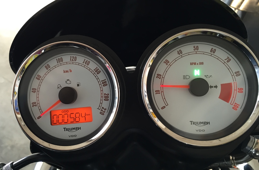

not having the alarm dashboard. a lure
no alarm .. right

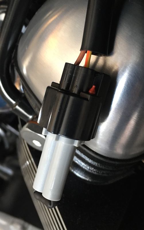

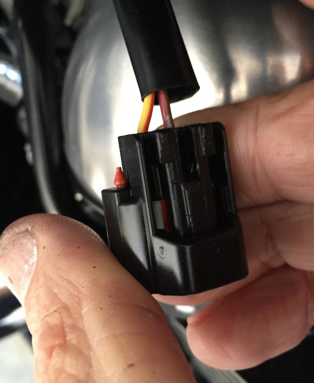

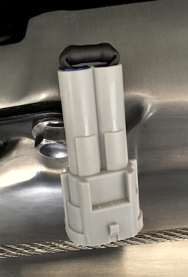

Good photos, thanks. Is that a shop-bought resistor device to plug instead of the solenoid, or did you make it yourself? if so, what resistor value did you use?.
2
@Forchetto:
it is a shop-bought resistor.
buy here
(if shipping costs are too high for the usa.I always look at how much is the cost if I buy myself and then I send you.
if it can save some money. as if someone needs something (tool or metric screws), ask me; with pleasure.
http://www.britishlegends.fr/fr/kit-elimination-ais-twins-triumph.html?id=34508652&quantity=1
tuto
https://app.box.com/s/ovjynn9cg81cnmj96wej
Great, thanks. It looks as if they've used the higher value resistors as we found out later were suitable, probably 470 Ohms.
Originally it was thought 47 Ohms were needed and therefore the resistor had to be of a much higher wattage. Here's a commercial example sold in the US, look at the size of that:):
http://bellacorse.com/shop/custom-p...eedmaster/engine/efi-ai-solenoid-bypass-plug/
https://www.newbonneville.com/html/ai_removal_kit.html

when I'll clean the bike, I'll disassemble the shop resistor and measure it.
to see how much the value is. effectively,mine is easier to fix and hide on the frame.

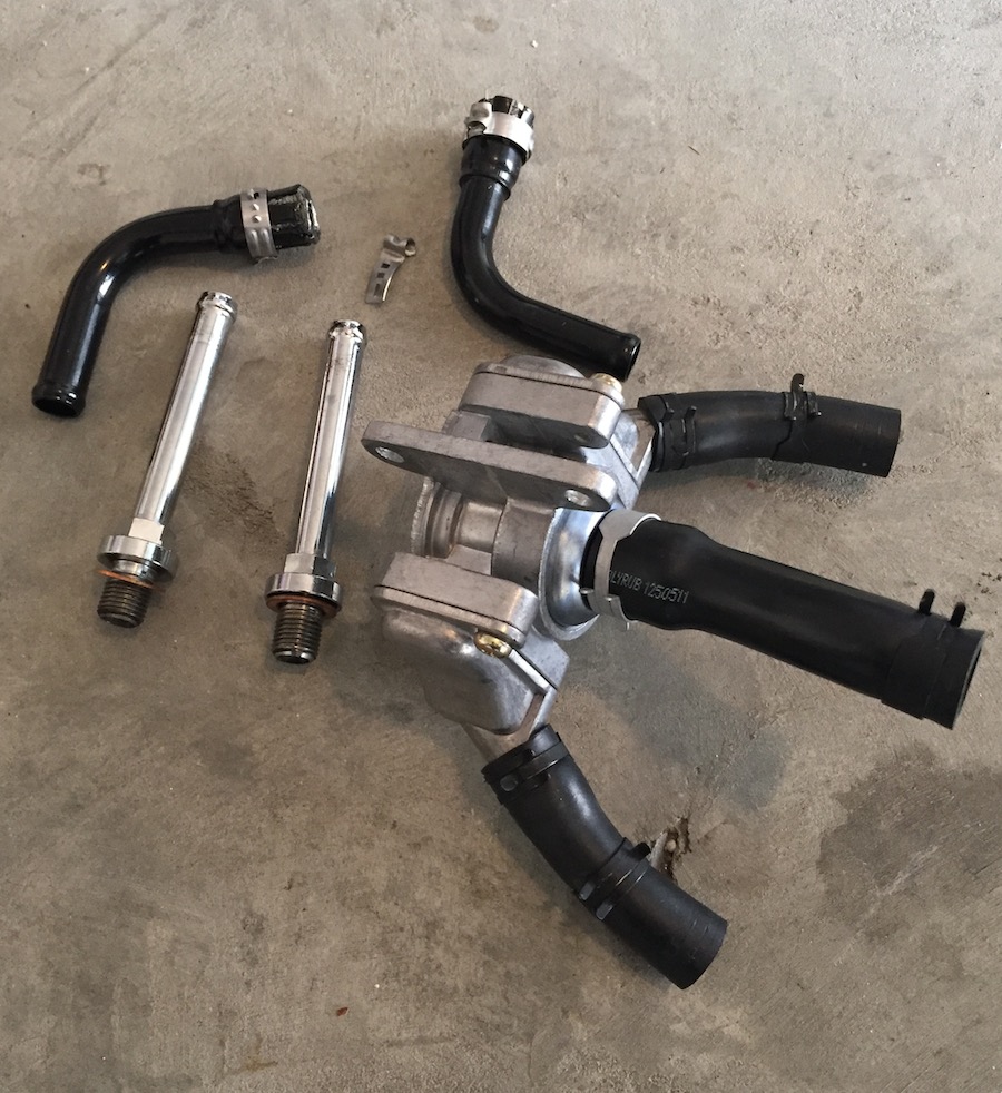

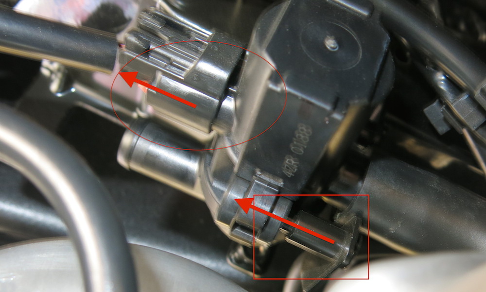

you may simply remove these parts:
and keep up the solenoid.it runs empty. that's all.
