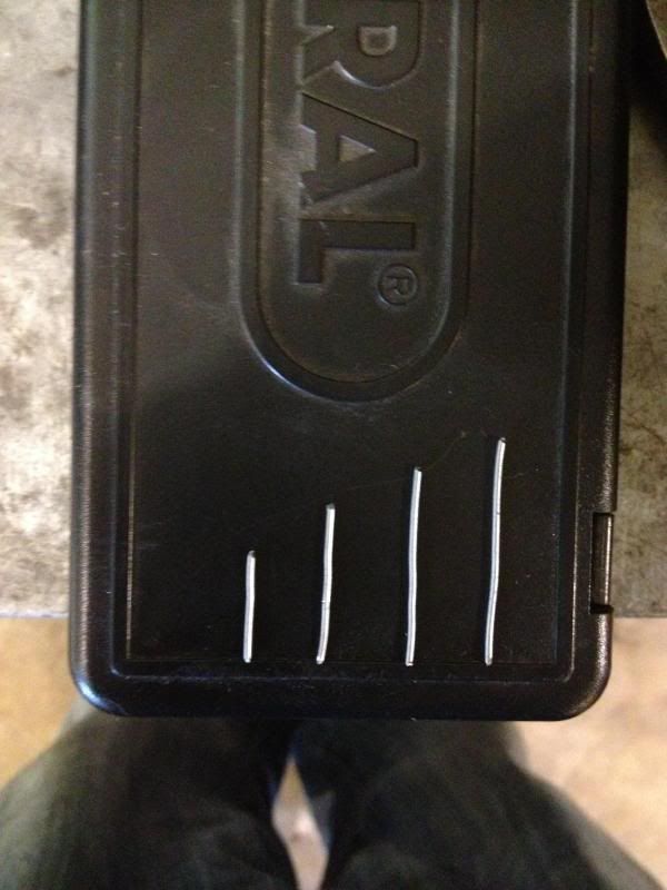

First off I would like to thank everyone who contributed to this post, it has been very helpful. I was unhappy with the stock throttle tube so I purchased the Rizoma Grips and ran the largest cam. It seemed like a huge improvement from stock and I was happy until I started doing more track days. Lately I have found it difficult to get full throttle on the coming out of a corner and decided it was time to step up to the R6 throttle tube.
Overall I am much happier with the R6 throttle tube, and it really isn't that much larger than the Rizoma large throttle cam so it can still be smoothly rolled on (not the On/Off switch I thought it would be). I paid $24 shipped on ebay for the 08+ R6 tube, housing and cables. I ended up using the R6 housing to avoid modifying the stock one, which did require drilling the clip on due to the R6 housing having a locking pin to prevent the housing from moving.
Below are my measurements to help others decide which setup may be best for them.
Stock 06 955i Cam = 32.25mm
Rizoma Small Cam = 34.00mm
Rizoma Large Cam 37.85mm
08+ Stock R6 Cam = 40.75
Here are a few pictures to show the difference in turn between the tubes, (Stock 955, Rizoma Small, Rizoma Large, 08+ Stock R6)
I also used wire to better illustrate the difference in turns between the tubes (From left to right: 08+ Stock R6, Rizoma Large, Rizoma Small, Stock 05 955I)
