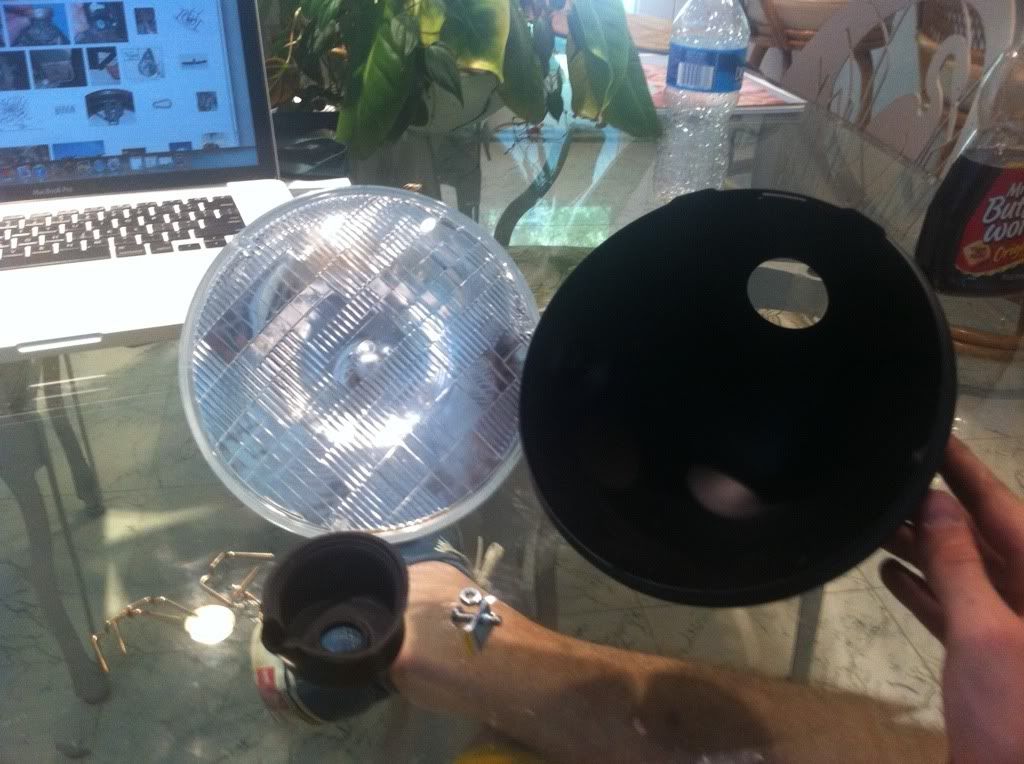

Im currently putting an old bonnie back together and cannot figure out how to assemble this 7'' headlight I got off ebay. Its got 4 clips and a tiny chrome bracket.
Anyone have a clue?

You seem to be missing the outer rim. The glass bit sits inside that rim and it's held by those 4 clips.
This bit:
Clips fit like this:
The chrome bracket is probably the means of fixing the rim to the shell.
