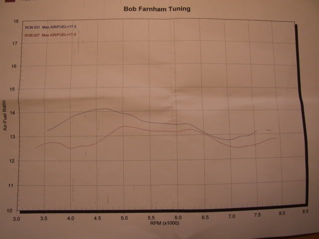

I have now had the Thruxton back on the dyno with the Predator exhausts. This was to check if the fuelling was OK with 138 main jets and stock pilot jets. The needles are raised with one shim. This was the set up with the TORS and K&N pod filters. I can confirm the fuelling is fine, with no change to the existing set up required.

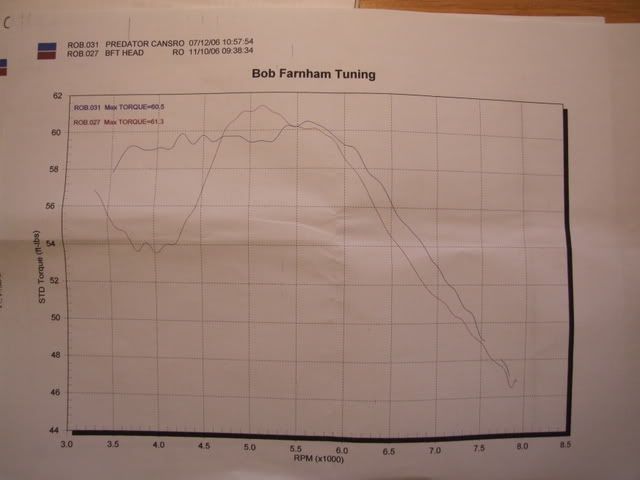

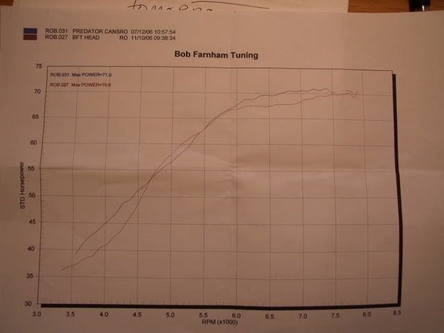

Here are the Torque and Power dyno graphs showing the TORS curves (RED) and Predator curves (BLUE). Maximum power and torque are similar for both exhaust systems. The Predators do give more power and torque almost everywhere else. The huge dip in the torque curve with the TORS at 3,500 to 5,000 rpm is no longer there with the Predators.
TORQUE: TORS 61.3, Predators 60.5 ft/lbs
POWER: TORS 70.6, Predators 71.0 bhp
Fuel/AIR RATIO:

Nice to see dyno tests. The conclusion that the Predators produce more power than the TORs is, however, not supported by the data because the fuel air mixtures weren't really dialed in for either system. And in the case of the TOR's the fuel:air ratio was over rich ( <13:1 ) where the torque drops in comparison to the Predators.
In the case of the TORs, the rich mixture caused the loss in torque and horsepower, not the other way around. A test where both systems ran closer to an optimum air:fuel mixture throughout the rpm range would likely have produced much different, and more usable, results.

"I believe it was actually running richer on the TORS, and close to where these engines produce the best safe power(recommended between 12.8-13.2 A/F ratio) :) "
Yup; too rich perhaps?

12:1 air/fuel ratio is richer than 13:1 air/fuel ratio. My Thruxton produced it's best top speed at Bonneville at 13:2 A/F. Leaner, it ran hotter, but no faster. :-D Eliminating the shim would make the midrange leaner; going to a 145 main would make topend richer. :razz:

"12:1 air/fuel ratio is richer than 13:1 air/fuel ratio."
TCB: You're absolutely correct. Just reverse everything I wrote concerning air:fuel mixture and I'll stick to THAT story.
The point being you've got to have the optimum air:fuel mixture consistently throughout the rpm range for maximum power and for useful comparison test results.
