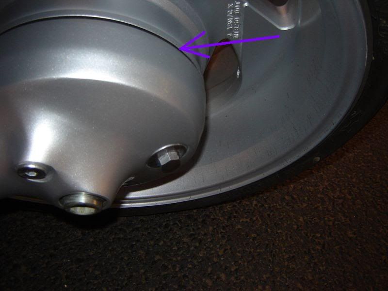

On the last couple of rides I have noticed oil streaks on the rear wheel (diff housing side) cleaned it up but back it came, the rides were at least 200miles. Is this the start of the famous rear bearing trouble. I will swing the bike by the dealership this weekend and let them check it out. (the bike was bought new June 2005 has 14000miles) :???:

If it looks something like this it is probably too much grease on the gears in the wheel. Common when its hot out or ride alot, esp. after tire change or wheel removal. Should only last a little while.
Did have the tyre replaced about 800miles ago. Will have the dealer check it out and let you know. :)
There is a spline set up in there that must be greased before reassembly. If they over greased it, it could be your problem. Also i think there is supposed to be a rather large o-ring there to help seal it. Tell Dink i said "HI". Find out if he is hiring any Rocket mechanics yet! I got experience! :razz:

Took the bike to the dealer he removed the rear wheel and checked for excess grease none to be found said keep an eye on it if it happens again he will replace the rear diff (under warranty) This bike coverd over 13000 miles without any streaks on the rear wheel riding in all conditions from 30degrees F TO 105 degrees F
