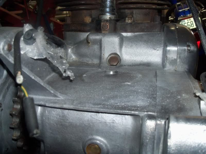

Got a little tired working on my frame so I turned my attention to the Motor cases.
I pickup a Soda-Blaster from Harbor Fright.
Before...
Blaster was very easy to use and quickly removed twenty five years
of oxidation from all cracks and corners.
Its not an end all to be all for shiney cases but its an outstanding cleaner.
I this picture the before is the triangle patch, just soda blastered on the bottom half, top half was wet sanded with a quick buff.
Jim
