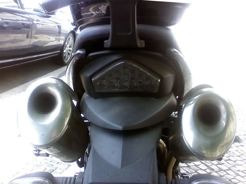

Yeap. Check the pic.
Everything seems to be tight and the right muffler doesn't move or shake but it's getting lower by the week!!!
I'd loosen all the clamp bolts for your exhaust system and once everything is all wiggly, then wiggle away. Move everything around a bit and make sure all pipes are seated tight then line the pipes up as straight as you can and retighten the bolts.
If a little jiggle doesn't do the trick then you may have to get professional help.....
