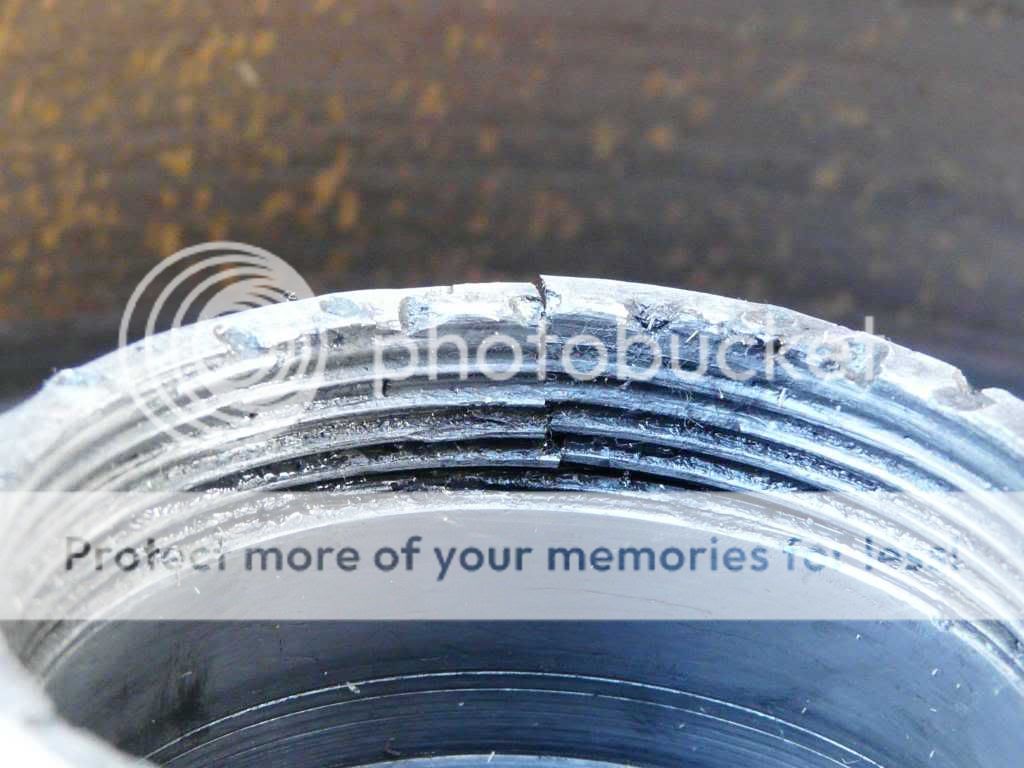

The photos are the LH bearing housing on the rear conical hub of a
'72 650 Bonneville.
It easy to see that some clown has had a field day on this, and I could go on about what caused it, but that is not necessary for you to assist me in getting this repaired.
The photos show a fracture, commencing at the edge of the locking ring thread and across to one of the reinforcing ribs. The housing has spread, causing the thread to misalign, and thus the locking ring will not grip or tighten. The bearing has, understandably, started to turn on its outer ring because it too is no longer a press fit.
Solution? I thought if I clamped the hub , and with the thread realigned, tacked a very small weld to hold it. Then place the lock ring into place and weld the fracture complete. The hope is that the welding might also just shrink the area a little (if cooled reaonably quickly) and thus allow for the bearing to be refitted as a snug fit with some Loctite 242 on both bearing and lock ring.
Has anyone been there, done that? And for the metalurgists out there, can this hub section be shrunk back, given the beating its taken??
Trust someone can give me some confidence about a repair here!!
RR

Thank you one and all for the replys. Deep down I knew a replacement was the go, guess I just wanted to avoid the hassle.
