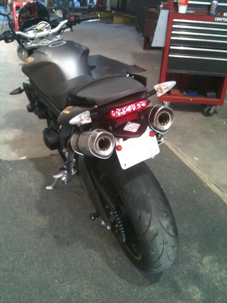

Hey everyone, i wanted a simple fender eliminator kit, but all of them were wayy to expensive. So I decided to make my own. What do you think?
this is when i mounted the turn signals on top, next to the brake lights. I didnt like it after a while so I moved the signals to the arrow straps.

Hey sorry it took a while for me to get back to you. I was with a friend and we fabricated 2 brackets out of light weight 6061 aluminum which took a bunch of tries to get right.
I am actually working on getting a kit ready that includes all the hardware, and the brackets (painted black) along with detail instructions and video of how to do the install. I dont want to go through all the effort if there is no interest. The price is set at $50 shipped. Pm me if your interested. If I can get atleast 10 people interested, then I am going to go forward with it.

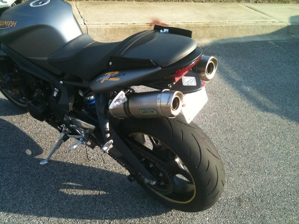

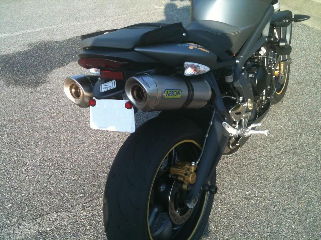

I will see if I can dig up pics of mine, but its really simple.
The tag bracket is just a piece of angle (steel or aluminum will work) that is drilled to accept the plate, and it mounts to the rear foot peg brackets. It locates the plate between the pipes going into the cans. The factory tag light was installed underneath the tail with a screw that goes into the " storage area" behind the battery. The turn signals are also attached to small pieces of angle that attach to the can brackets.
261 Posts
These are my current turn signal mounts. I went with these after removing the twin Arrows and going with a shorty exhaust. With the twin high mounts, I just added a small piece of angle going toward the rear of the bike that attached to the can bracket. The turn singnals bolted to the angle. Simple ,but no pics, and I dont plan to dig the Arrows out of the box for pics.
EDIT: you can see my temporary tag light in the above pic...the stock light works, but I had mine boxed up with some other stuff and was too lazy to dig it out at the time...
