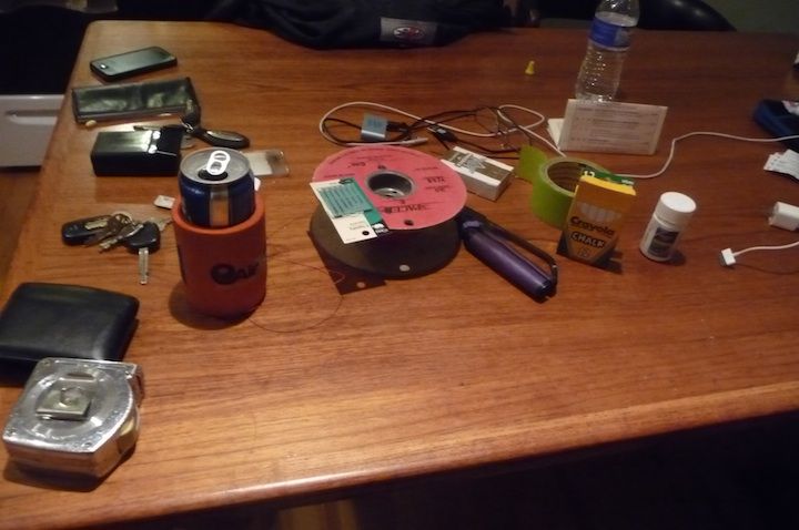

Tools required so far...
Note: beer and smokes are at the top of the list. So far I've got about 3 hours into the layout and stitching.
