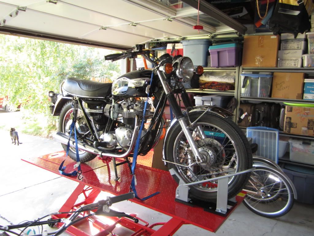

Hello,
With the 50% off coupon ( found in motorcycle magazine ), it was $ 299.98 . The quality is pretty good and it was well assembled. It takes quite a few " pumps " to get the full height ( about 30 " ). The pedal to lower it is super smooth and easy to control. I replaced the useless wheel choke that came with it with an upgrade which while cheap is not much better for the small wheel of the Triumph. You need straps to secure the bike, or put in on its centerstand. As I picked up the rear of the bike, my wife lowered the centerstand. No need to move the bike rear ward or forward for off. The rear plate comes off to facilitate the rear wheel removal. The paint and finish are good, but very slippery. Could use some truck bed liner paint. Overall, very happy but kicking myself for not buying it years ago. I am a cabinetmaker and never buy hand or power tools from Harbor Freight Tools. I need the best tools that will do what I need them for and last for years to come. But in all honesty, stuff like that lift table ( or a can shaker ) are just very good value for the service they provide and I also need to say Harbor Freight has a very good after sales track record with me.

Here's the pics of the wheel clamp I built. Built two of them, actually.
You need to put a piece of angle iron along the bottom of the lift table on each side to stop it from flexing. My fingers are pointing to the bolts that mount the clamp base and one end of the angle under the table (left bolt) and the other end of the angle (right bolt). If I had made the base plate longer (spanning those same two bolt holes) the angles under the table probably would not be required. I did not have a piece of steel that big so this worked fine.
Those boxes in the background are my '66 T120R project that has been on hold lately.

Hey Rob, nice job on that custom wheel choke ! I guess I will volunteer to buy the second one you don't know what to do with ?
It does look as if it is exactly what it takes to hold a bike : high vertical support in the front and a way to fit it to the tire width. Well done !
