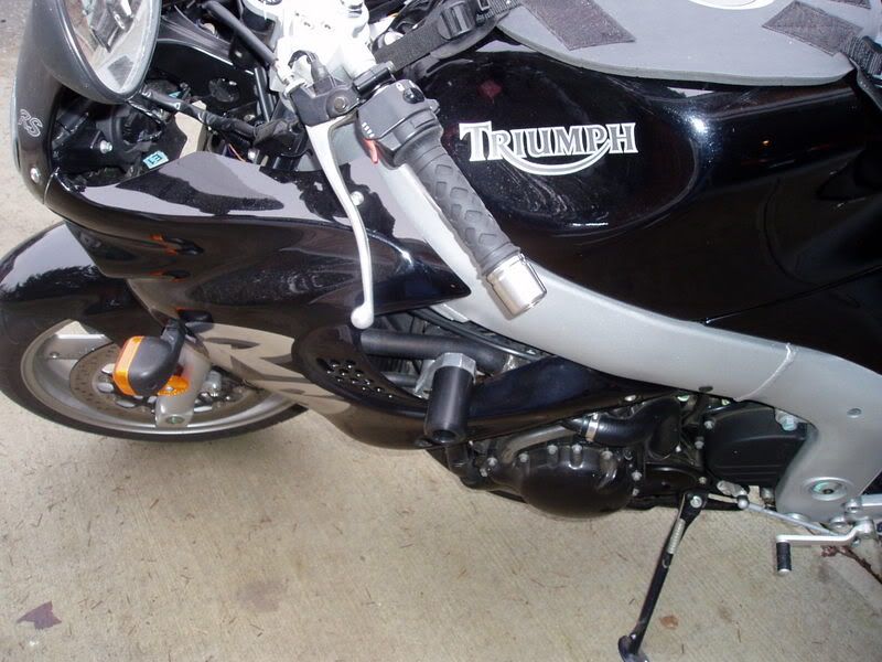

There's a pic of the ST 955 R&G's on a Daytona 955 on the Jack Lilley website:
http://www.jacklilley.com/view_part.asp?category_id=12&category_type_id=134&part_id=4681
From my use of the R&G's, I'd say that on a drop or low speed fall they will stop damage to everything - as long as you don't go across a kerb. Then again, running anything across the kerb is going to cause problems.
Going down hard at at angle will bend the bolt. That's a pic of my bike Kev has posted. Even so, these bungs did stop the damage from being worse. Granted, the panels will need replacing anyway - but there is also a safety angle.
The R&G's come out quite far & were handy in keeping the bike from completely trapping my right leg during a slide. That must have contributed to the fact that I was unscathed by the slide. I'd rather that than bother about the panel too much.
Kev - on your original point about bent stems snapping the bodywork - the bend here was a bend of the bolt, not the mounting frame. So, if the mounting protrudes through the fairing for the bung to be screwed in, then I don't think you should worry too much. The bolt holding the bung will bend if it hits at an angle at a decent speed, but that shouldn't harm the fairing if the end of the mounting stem rises clear of the bodywork in the first place. I suppose I'd rather the bolt was weaker that the mounting stem, so it doesn't force the stem to bend to the same degree as well.

The pics just posted are almost identical to my bike. Good choice BTW
Skykings eh... I did buy these direct from the States for my last RS. Not sure that the bracket would not pivot around and again snap a panel. I suppose given the cost, (£55.32 for R&Gs), I should get them. :-D
