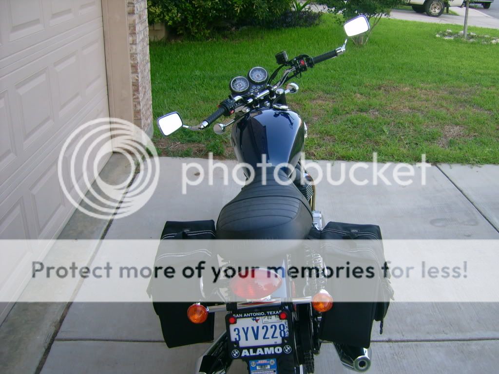

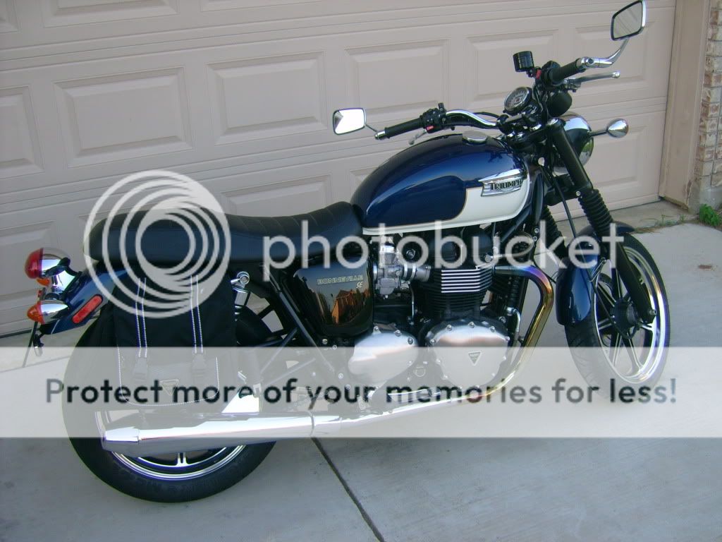

This weekend I spent a few hours dressing up my SE. I installed fork gaitors, an anodized brake fluid reservoir, bar end mirrors, and I peeled off those funky stick-on reflectors from the forks. This forum came in very handy while bleeding my brakes after insalling the new reservoir. I tried the "tie the brake handle back and let it sit overnight" trick, and it worked perfectly. Thanks for that Prop! Here are a couple of pictures of my new and improved Bonny...

Looking good! I'm lovin' the rainbow colours on the headers.

The bags are the Triumph nylon panniers, I had the dealer put them on prior to delivery. As to mirror fitment, I did have to modify the cylindrical aluminum spacers that came with the kit. They were too long so I filed them down until they were the proper length. Worked like a champ. JCF66, The fork gaitor install was pretty straight forward, they came with very good instructions. There is also a tutorial thread in the forum that I referred to a couple of times and it helped alot. The plastic fork protectors were pretty easy to remove, just tapped off with a hammer and piece of wood. The only tools I had to buy were a set of allen head sockets so that I could use my torque wrench on the tripple tree bolts. Not too difficult at all, and if you get stuck there are plenty of people here to help you out. Go for it man...
