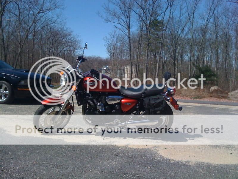

The bike looks great as far as I can tell. A few minor scratches here and there, nothing major. Buyer was nice enough to tow it home with me. I decided to wait for it to be registered/insured before hitting the highway.

Nice lookin bike beastman, looks well cared for.

Great looking bike there Beastman...how many miles??...looks like you have a king and queen seat..your going to like that.......enjoy!!

I'm pretty sure that's a stock Legend seat, very much in the K&Q style tho'.
