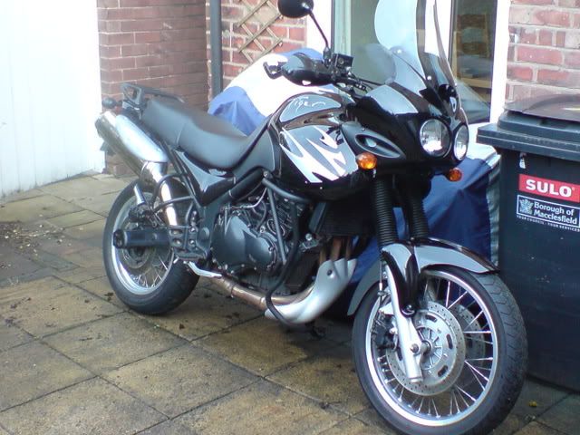

Hi all, time to pick your brains..... have seen lots of people changing exhausts on 955i Tigers and going to the Triumph Off Road tune and being very happy with the results... anybody have any experience of what I could expect with a change of can and off road tune on a 885i ?? Is there a noticeable difference ( apart from the noise! ) Does fuel consumption get hammered?
Thanks in anticipation.. pic attached of my new toy in need of a good clean and a few choice extras

Looking at the picture someone has been working on the exhaust because the square collector box has gone and has been replaced with the straight through pipe that came with the offroad silencer as part of the kit,hence the different part number.
Well spotted wingerwhy remove the cat if your not fitting the TOR?
Stoph, the only visible difference between the Triumph cans is a stamp that Triumph put on to inform Mr Plod that your running an illegal exhaust, it can be found between the heel guard and the lower rear footpeg hanger bracket.
Nice try...... but the square collector is still there.... just very well hidden from that angle!
I'm guessing half the performance increase probably comes from losing that box in favour of a nice straight bit of pipe too.....

Must be the picture,whats on the joint corrosion or a jubilee clip!!,you can't buy the kit anymore they stopped it some time ago,unless you can find an old one in stock,or talk to the people who originally made e'm Motad!!!
I could write war and piece about that system,i had the first in the UK in 99 it didn't fit and neither did the 2nd or 3rd,the dealers didn't even know about how to run the system with a tune,or put the pipe on the collector box and not bother with the straight through pipe,i actually cut both the dealer and Triumph out in the end to force the situation as i knew who made e'm,but thats another story.
I ran mine both ways,you'll get more HP with the connecting pipe but less torque than if you carry on with the collector box,but it's easier to clean without.
Thanks Winger... its a clamp on the pipe just below the brake pedal although there is a little browning that needs cleaning off... If keeping the box means keeping more torque may just look for a silencer/connector to the collector box so I get torque and a nice noise too It may have to wait however... managed to get out for a ride today and had a few 'issues' that I need to research on the boards...or ask in a new thread
