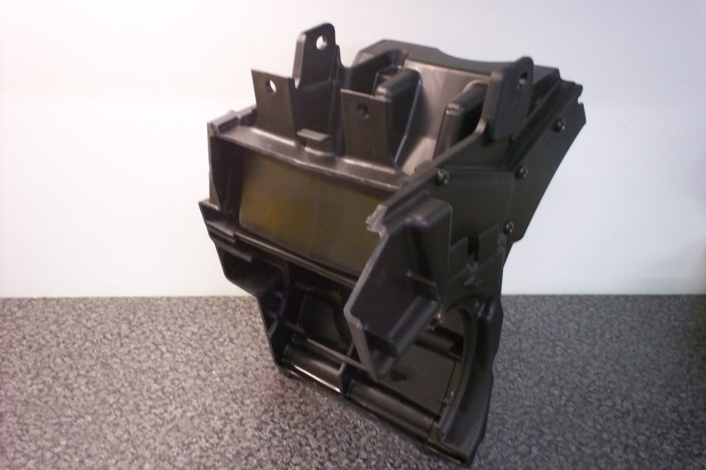

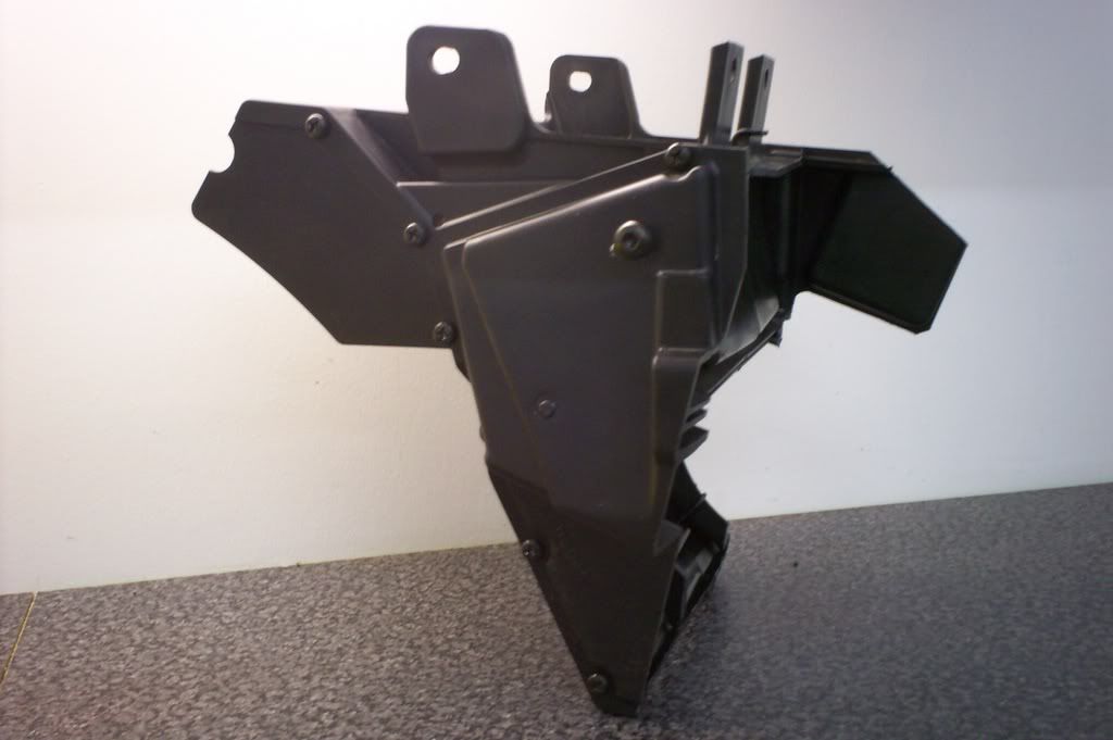

I found that of all the weapons in the armoury a normal woodworking 'jack' saw worked best for getting a straight/clean cut in the plastic;
And the RHS;

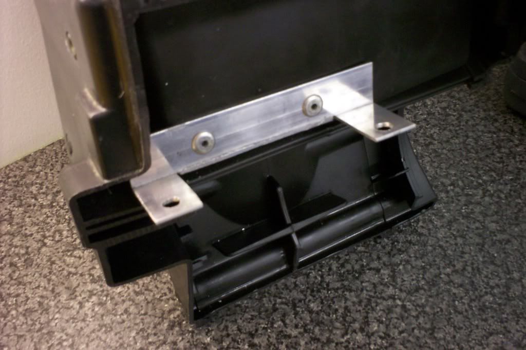

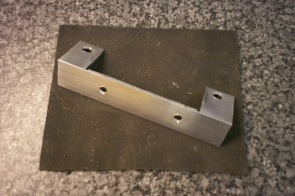

I made up a bracket for the fusbox from some aluminium angle;
and fitted it with rivets. I have washers under the rivet inside the batterry box;

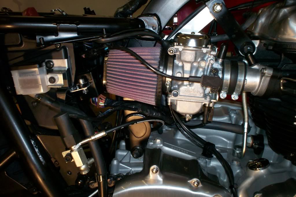

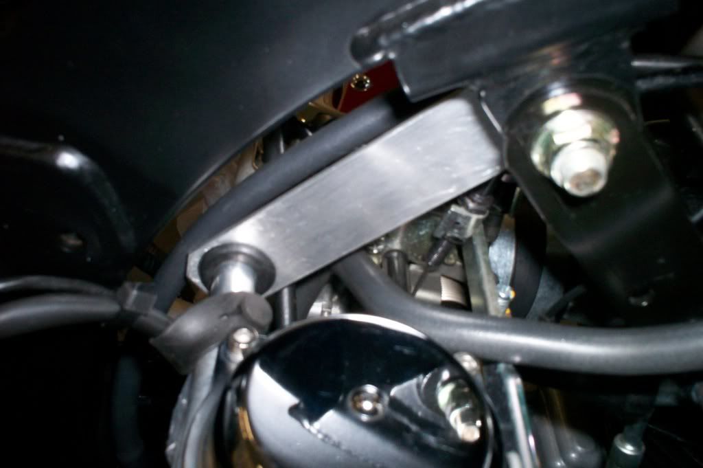

I had a few ideas for a carb brace, but when I measured some rubber grommets that I had were 12mm ID, I simply fitted one in a piece of flat aluminium, put an M8 clearance hole in the other end and there we have it;
voila;

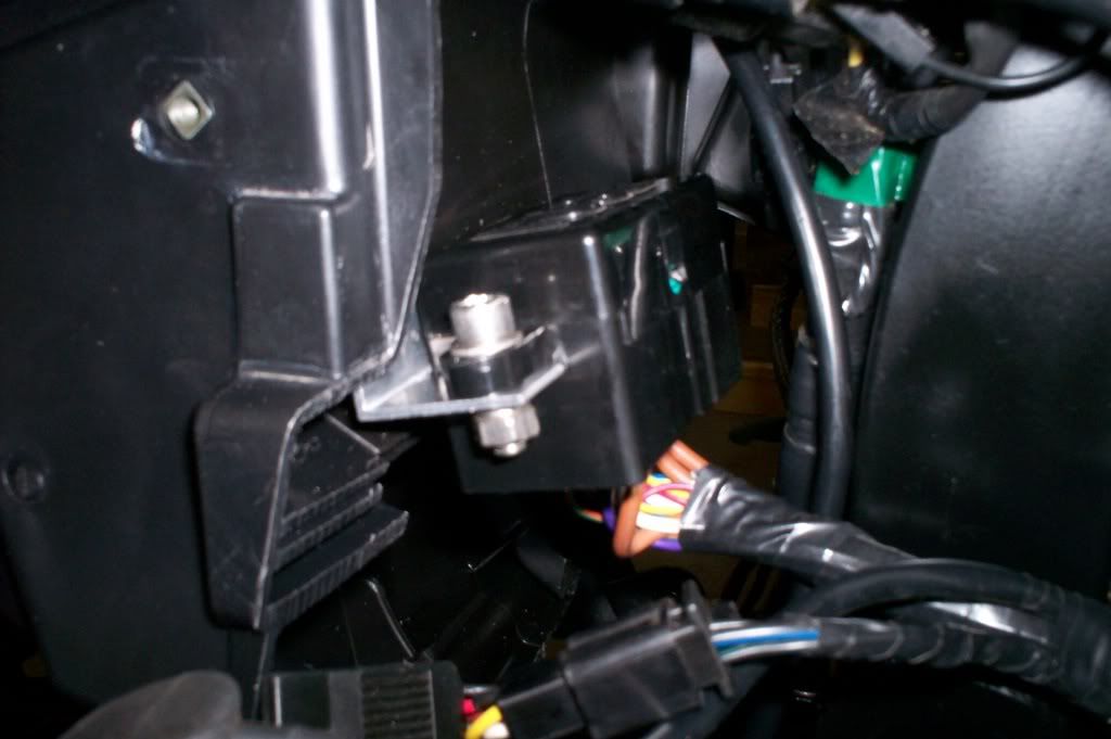

Forgot to show detail of the fusebox fitted;

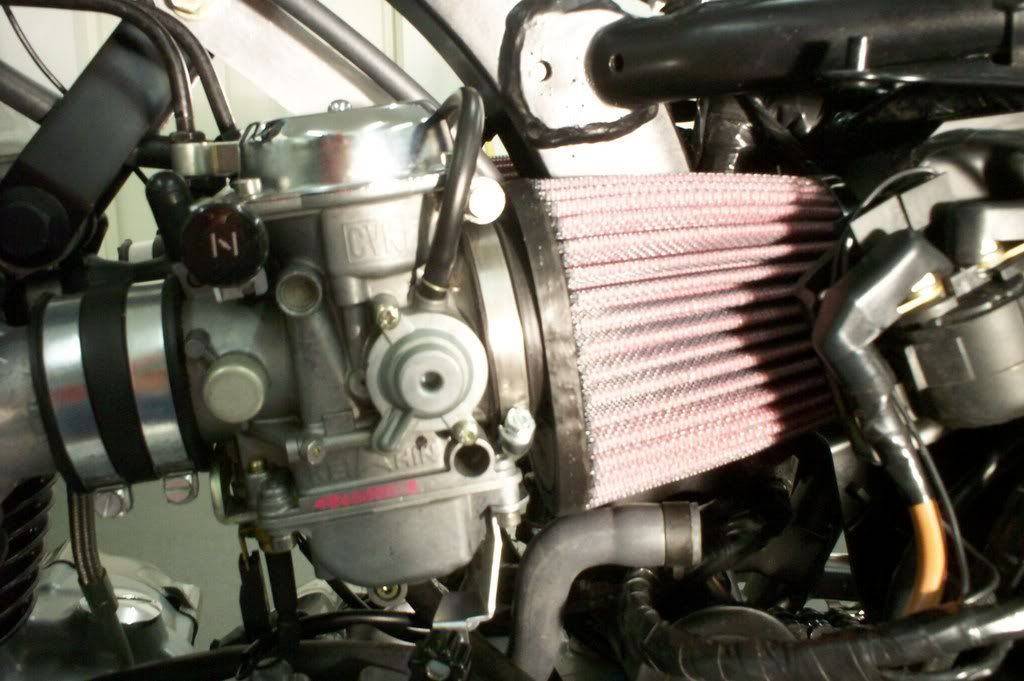

I used the K&N's that have been widely reported on this site, RC2890 and RC2900. They are pretty expensive in the UK, but the quality is without question and UNI are not available at all in the UK (other than the 'stock' filter that Jenks keeps)
Drilled the slides (3mm) while I was at it. Kept pilot jets at standard (40) and have gone with 138 mains, 1 shim under needle.
