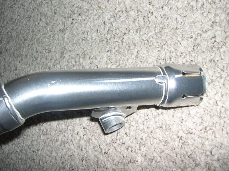

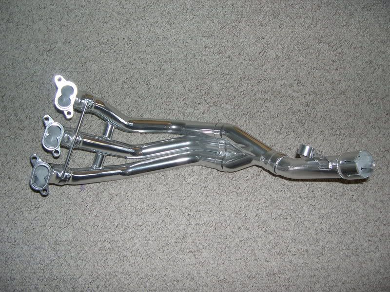

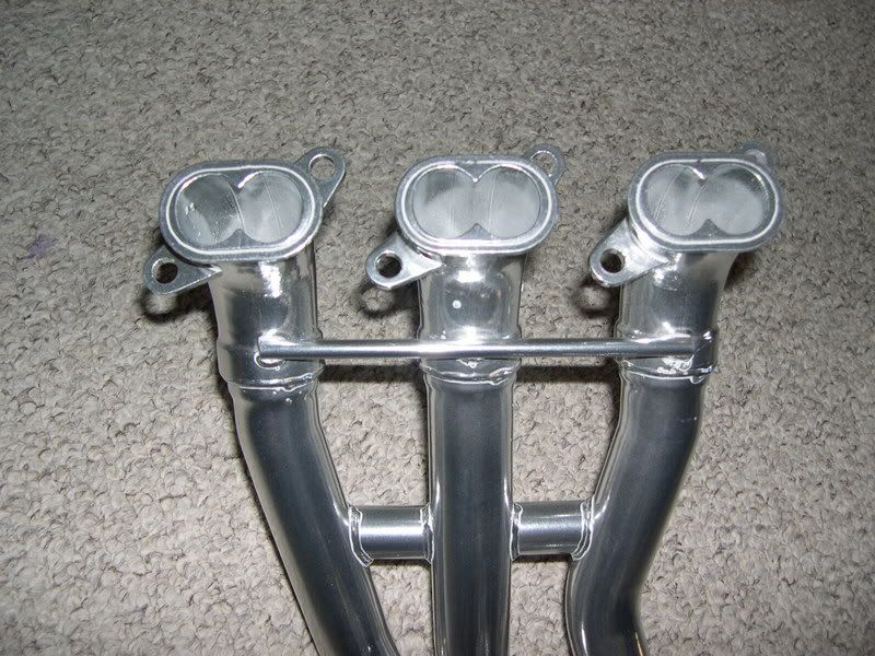

All,
I finally got my headers back from Jet Hot with a shiny new ceramic finish good up to 1300 degrees. No more having to try and shine up my headers. They should stay looking this good for a long time. The total cost was about $160. Not to bad.
I had Ted help with the removal of the baffle and weld up the holes that were left behind. All you have to do is drill out the 4 spot welds and the baffle comes right out. Then you weld up the holes and your done. So I sent it off to Jet Hot, had them ceramic coated inside and out. The coating also helps with heat dispersion and exhaust scavenging.

Spindlbeak, the headers look great.

Fantastic job on the headers spindlbeak.
I've seriously got to find myself a place in Aus that do ceramic coatings, they look truly magnificent.
591 Posts
To he!! with polishin them bad boys every week, ceramic coating looks like it's the way to go. I'd bet black would look sick like that.
