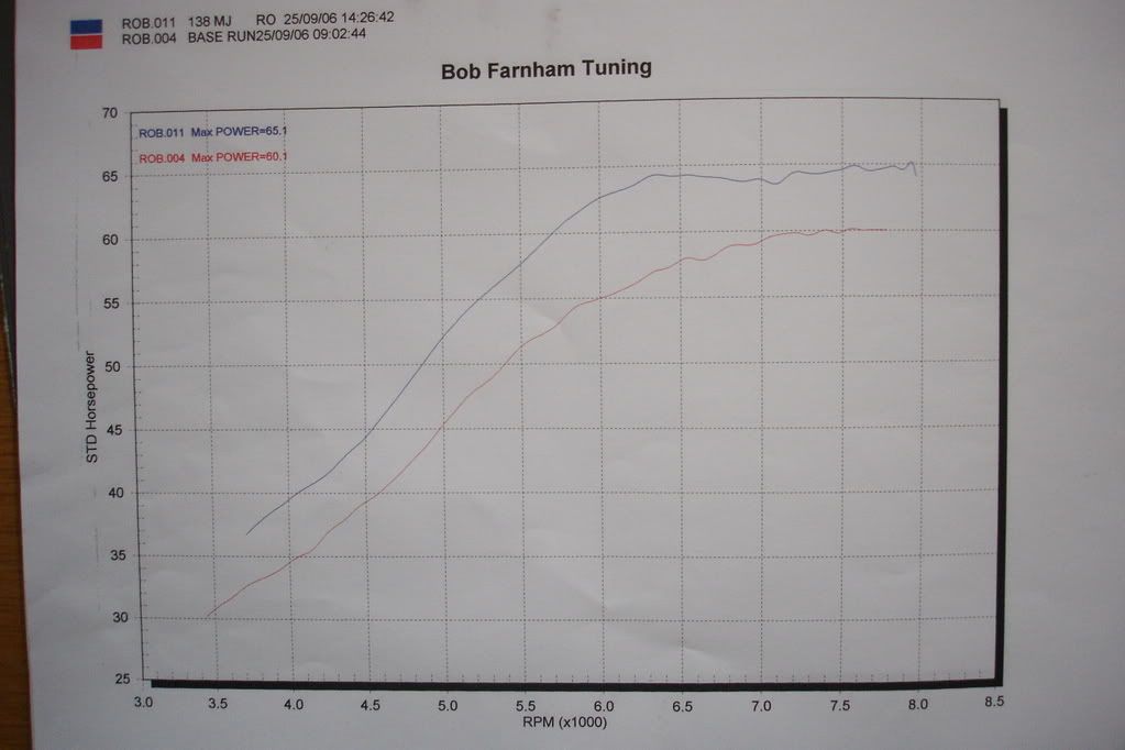

Despite some of the comments on this thread, airbox removal, K&N filters, rejetting and head work DO work, and worked very well on my bike. This work was completed by a highly respected tuner and represents an overall power and torque increase in excess of 30%. Stock Thruxton's on his dyno make 52 to 53 bhp before modifications.
Here are the dyno results from the tuner's alleged conservative rolling road. He indicated that other dynos give higher figures than his one. This guy prepares race tuned engines for club racers, so knows what he is doing. The figures shown below are measured at the rear wheel, not crank.
The most important point here is not the actual figures, as dynos all read different, but the improvements achieved with the modifications, all measured on the same dyno, carried out by the same operator.
1st dyno chart shows bike fitted with TORS (60.1 bhp), and afterwards with airbox removed, K&N's fitted and regetted to suite (65.1 bhp).
2nd chart shows airbox mod (65.1 bhp) and afterwards with head gas flowed and skimmed (now 10.4 to 1) now 70.6 bhp
3rd chart shows the torque figures for the 3 stages starting at 48.6 ft Lbs, ending with 61.3 ft Lbs
