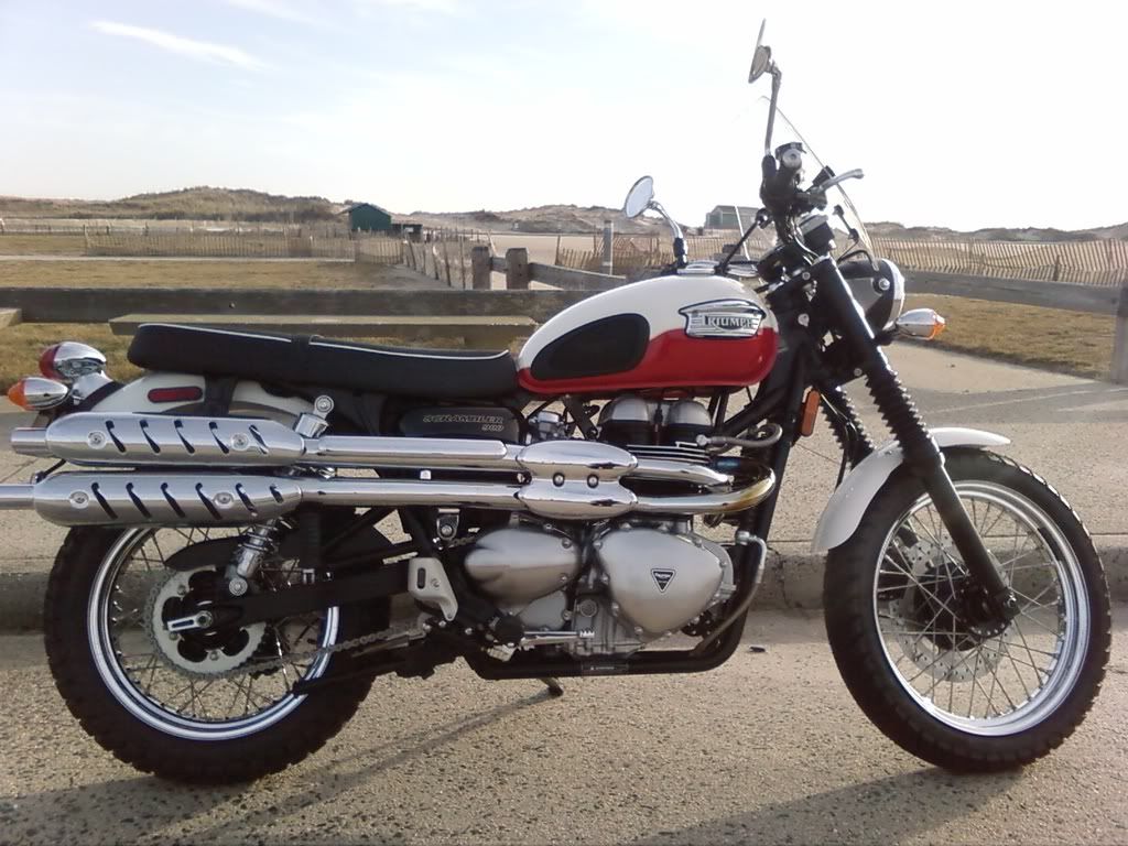

I'm kinda in limbo with my '06 Scrambler. I'm either going to put a gigantic windscreen on it for comfy ride, or I'm going to make a run at Thruxton-style looks, or I'm just going to sell it.
But I was wondering if anyone out there has ever given their Scrambler a cafe-racer treatment with clip-ons, rearsets and the solo seat and cap. Here's a pic of the bike just to keep the post interesting. :)

It would probably be quite a hassle to cafe a Scrambler. Rear sets would be difficult to fit as the Scrambler peg brackets are quite different. You'd want to change the tyres, seat etc. The plus side is that you already have Thruxton style fenders and Thruxton bars are 7/8 same as the Scrambler so bars would be fairly straightforward. As for the exhaust...?
1,934 Posts
You might have to do something different with the rear brake reservoir. Because of the exhaust location, you can't put it under the side cover like a Bonnie or a Thrux.

Well, the good news would be that the Scrambler's exhaust would definately remain. I love the old-school looks of it.

Not what you're looking for but it'd probably be easier to scrambler a cafe. High pipes on a Thruxton or something. Maybe the scrambler tank - but as they said above the rearsets would be tricky.
But the different seat and tires, and handlebars are all totally possible.
I always looked at building cafe bikes out of stock and standard bikes. It actually never occurred to me to cafe a bike that was specifically set up not to be a cafe, but I kind of want to now.
