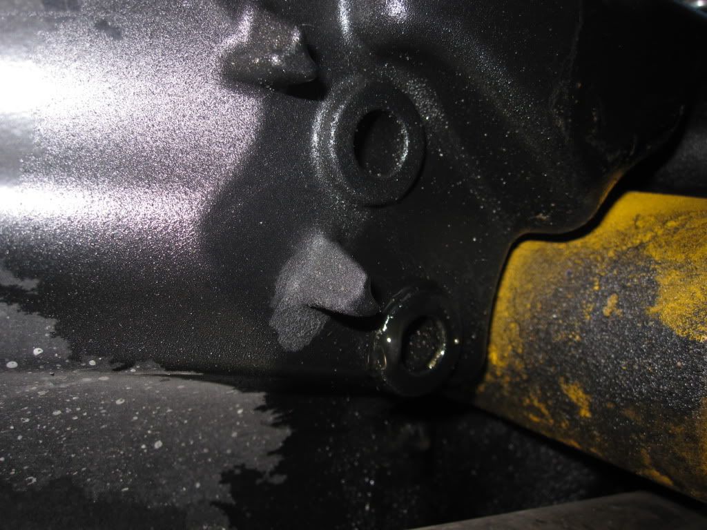

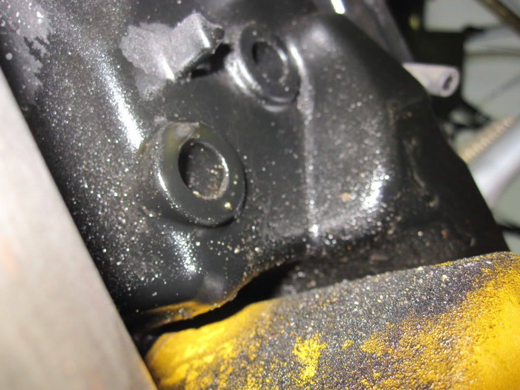

I'm hoping someone can take a look a the pics below and give my some insight as to wear I need to look to find the source of this leak. Is it something quick and easy to check/fix, or do I need to take it to the dealer (still under warranty). Haven't noticed anything on the ground, However, I do see a couple of spots on the arrow pipe where it's landed as well as obviously the oil filter. I noticed the leak doing an oil change, but had assumed it was the oil filter leaking, but now that it's got a new filter, it appears to be coming from this hole/vent in front of the filter. Thanks for the help.

hmm...trying to figure out those pics in relation to the bike.
but is that the drain vent under the airbox ?
have you checked your airbox recently ? as to how much the crank breather hose is spitting in there....
or have you checked to make sure the crank breather hose is still attached to the crank ?

I don't know how else to describe the location other than it's the hole nearest to the oil filter when viewed from under the bike. The yellow component in the pic is the filter. Is that where the crank breather vents?

How long have you had the bike, is that a weld repair above the filter and to the right.
Does anyone else have a black sump as mine is bare alloy.
And how old is that filter to be covered in crap like that ?

Bike is brand new - purchased in Feb. Now has 4500 miles on it. Filter in the pic is brand new - couple hundred miles old. I made sure the o-ring came off with the old filter - I thought the same thing.
As I mentioned, I changed the oil about a week ago when I noticed the leak originally - I had figured the fuel filter gasket had failed.
Changed the oil, cleaned all surfaces that had been in contact with the oil and went on my merry way. Checked again yesterday afternoon and this is what I see. I'm fairly confident the oil is coming from the hole nearest to the oil filter - I just don't know what that hole is or where it goes to. I can't get the bike high enough up in the air to get under the bike and have a look to see if it's a bolt hole or some kind of vent.
Again - thanks for everyones help - keep the ideas coming! It'll probably go down to the dealer on Saturday if I can't get it resolved.

Have you checked to see if all the hex bolts that hold the oil pan in place are tight? They will sometimes vibrate themselves loose enough to allow oil to weep. Apparently the way the wind moves down there spreads the oil everywhere and it's hard to tell where it is coming from.
Two different bolts have loosened themselves on separate occasions and a quick tightening fixed the problem. It's worth a check each one of those bolts all the way around.

Yep - forgot to update this thread. That's the exact bolt that was causing my leak. It was still there, but had losened up.
