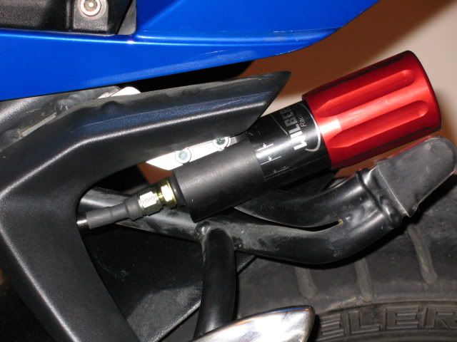

I fitted the pre load adjuster for the Ohlins to the rear foot peg, seems to work well:
Have now fitted K-Tech 20mm Compression and Rebound valve kit and Springs to the forks to give a much firmer feel , works very well and as a by product has stopped the problem with the headlights bouncing. :cool:
