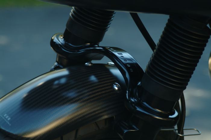

Just put the Super Brace on my Thruxton.
The look is more elegant then the other braces out there.
Thanks Chris!!
Here is a shot.
