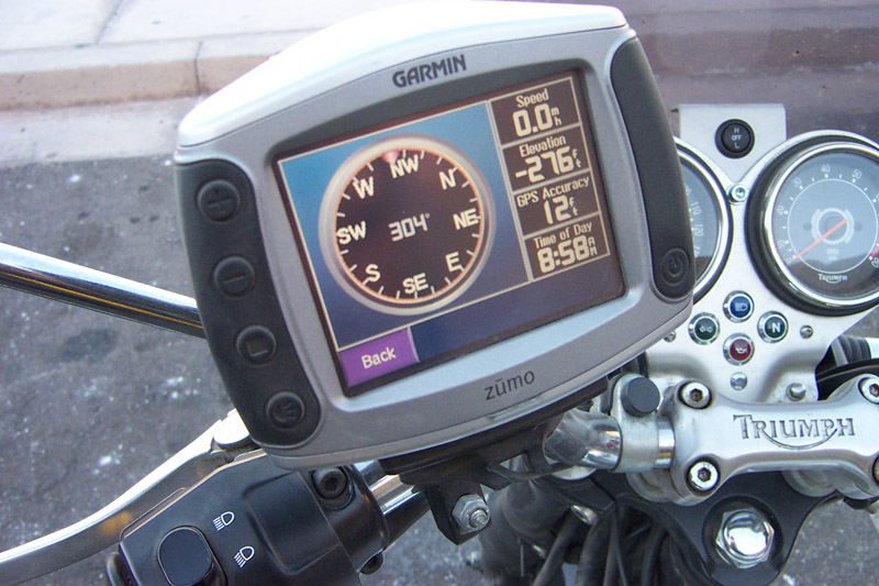

I had mine mounted on an aluminum bracket between my two gauges (in the background).
I think it works pretty well. It could use a little illumination, though. At night it's hard to see.
