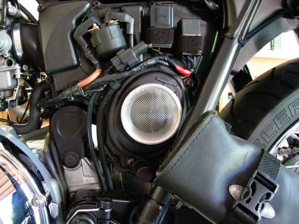

If you're going to remove the snorkel, you may want to get something to smooth out the airflow into the filter, and make sure you have a washable aftermarket filter. The options for smoothing the airflow are (1) Jenks rubber bellmouth (2) Norman Hyde Bellmouth and (3) Jenks aluminium velocity stack/bellmouth. I have a K&N filter and the Jenks aluminium bit. Here's a photo of it to show you where the snorkel is (or was). You still need to have the side covers on.
