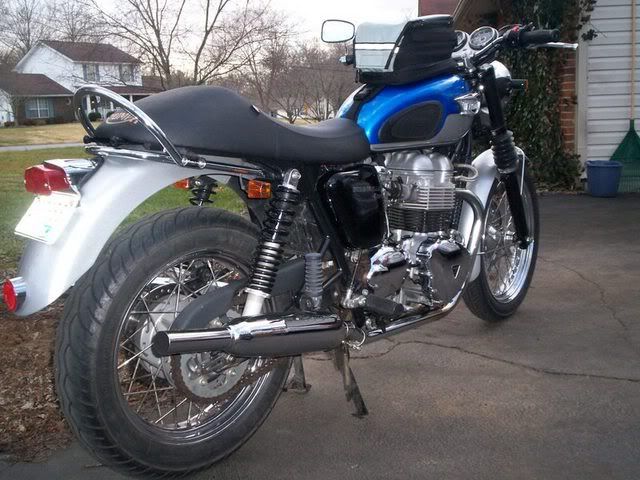

My front indicators are the same as the rears. I installed them in the same holes as the stockers:
