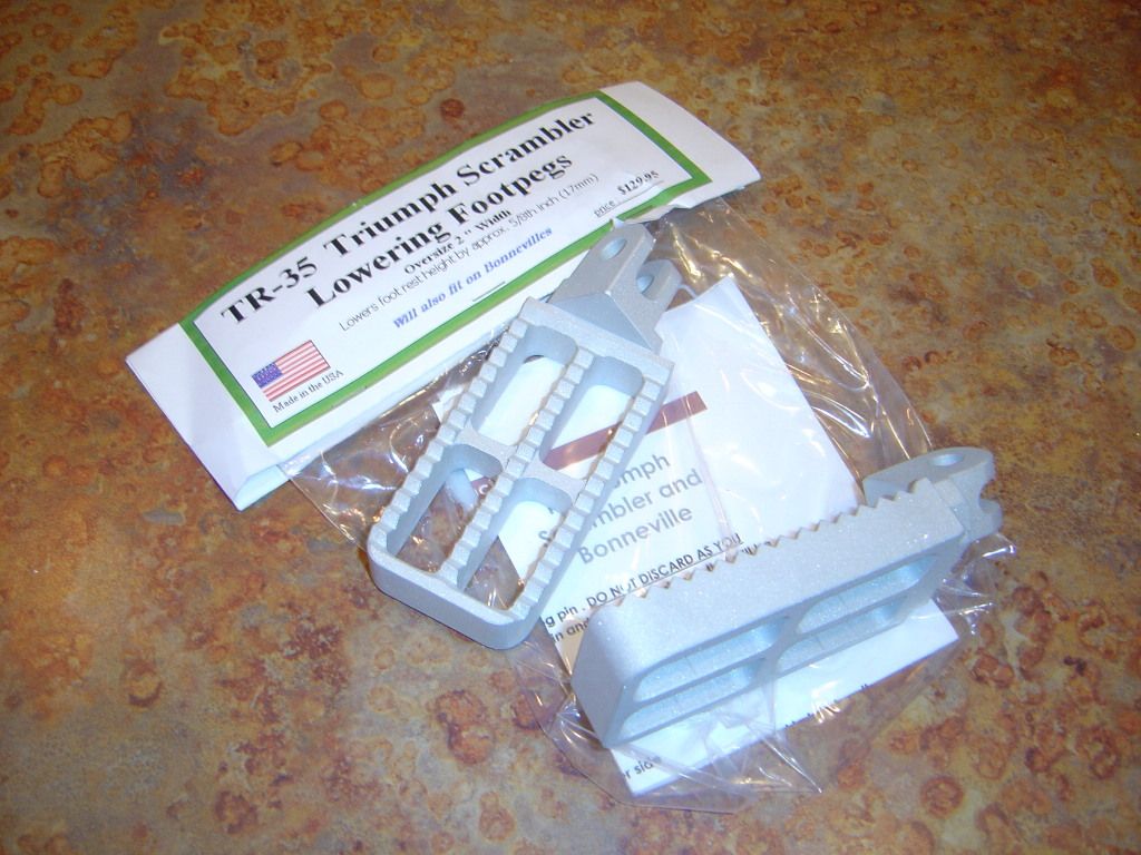

Tried a set of pegs for a R1. I had to drill them out and shim for fitment and I am still not satisfied with the final look. I am probably going to go with the Oberon or KNL set as a Christmas present to myself. I think am keeping the shifter lever, an Ebay special for around $25.00.

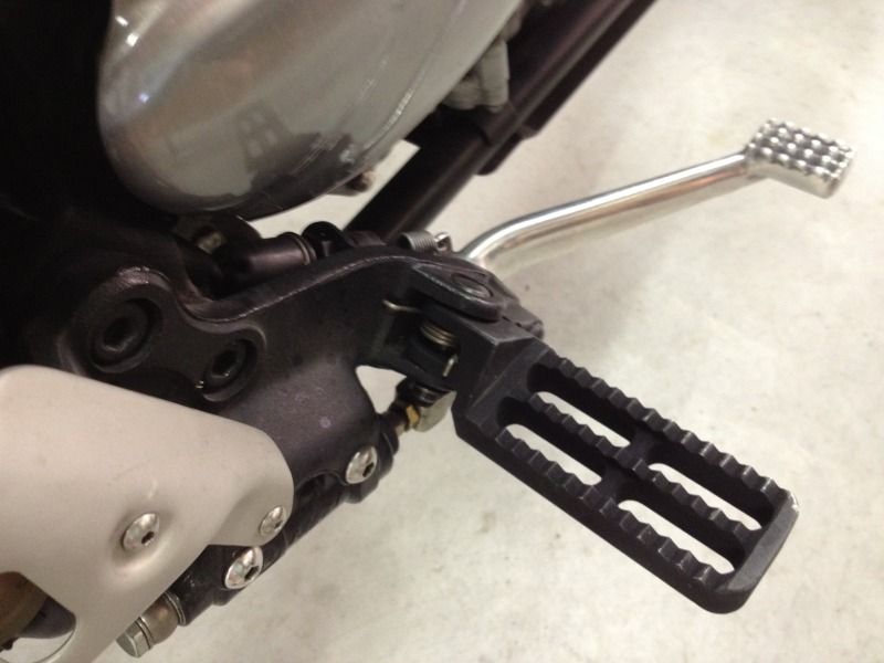

I could not be happier with my KNL's - but the cost of admission is steep
Dkreidel,
They really do look good on a Scrambler, leaning very heavily to the KNL's. Thanks for the shot. I hope you got out of snow country before the winter weather set in......

I got a package in the mail today from Ken at K&L. They are his T35 foot pegs which are 1/2 wider than the ones displayed on his website. These are perfect for my size 12 feet and I think I may shoot them satin black. Excellent quality and cut to order. Unfortunately I can't post a shot of them on the bike until after Christmas, Wife's rules. Since she footed the bill, I will obey.......
