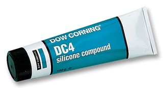

Try a thin coat of Dow Corning DC-4 silicone grease on the filter gasket before installation. I've been using the same tube of DC-4 on bikes, planes and boats for more than 30 years and it's still half full.
http://www.aircraftspruce.com/catalog/cspages/dc4.php
Also FAA approved

I still have a tube of Dow Corning DC4 silicone grease that I nicked from work nearly 30 years ago and it's still as fresh as the first day.
It can be used for insulating, lubricating, heat transfer, dielectric compound, etc, etc.
Whenever you remove things like car water coolant hoses, vacuum pipes, etc smear a bit on the connection. Years later they come off without effort.
If you really hate someone, smear it over his windscreen, it's impossible to remove completely...

Yep, it's good stuff! Don't get DC5 or DC12; one's runny and the other's snotty.

+1, thats strange,but I did the same thing,nicked a tin from work,had same tin 20 years, and its still good to go.
