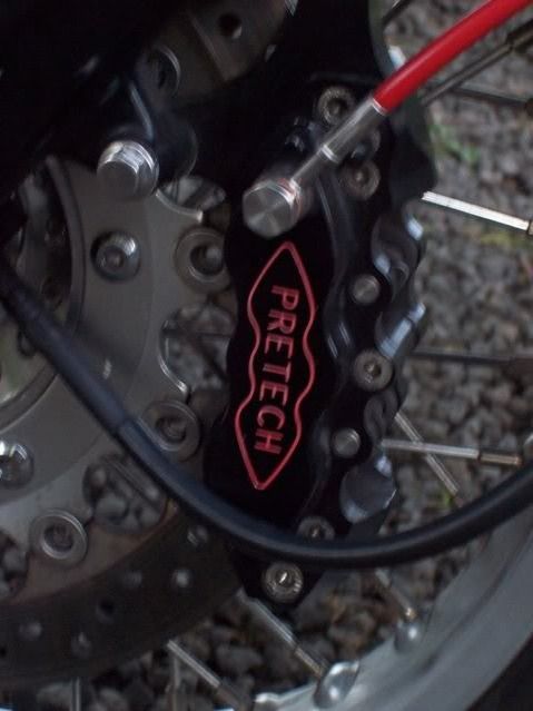

Hi all ive got a Pretech 6 pot Caliper on my 2004 Thruxton.
I wasn't very happy with the feel and the way that the Standard master cylinder operated the brake. There was also the annoying bleeding that took too long as well. So I started looking for the cheap upgrade. The general consensus was that a RGV250 Master Cylinder or a Triumph Speed triple one would both give you the desired feel and pressure. The RGV250 master cylinder was the cheaper so i bought one for 15, the speed triple ones come in around 70. However there is a difference between the two, the RGV is a 5/8 master cylinder(15.8mm) were as the speed triple is a 14mm master cylinder bore.
Fitting was simple as the RGV master and the Thruxton master are almost the same. I aslo fitted a master cylinder rebuild kit before fitting. The two things that cropped up when fitting the new master was that the banjo bolt was not the same thread as the standard one. Luckily i have a spare one in the shed that fitted, second was that the inlet from the reservoir was pointing the wrong way. All a did for this was move the master cylinder reservoir.
I have to admit it bled very easily and gives a much stronger lever, unfortunately it is at this point after a long ride that i have deceded that even though it is better than the original i think the Speed triple would have been the better option. The standard Thruxton master is an 11mm bore and in my opinion doesn't pump enough or give the right feel. However the speed triple master at 14 would be the perfect compromise. In the future i will be changing to the speed triple master as the RGV (16mm) is too large and doesn't give much feel and will give you fore arm pump when riding fast for long periods.

Nice Mod Chris and thanks for the write up with pics - I saw one of these on a thruxton the other day and it definately caught my eye.
I've just done EBC pads and am happy with the improvement but this would be my next step if I wanted to ratchet up the braking power even more.
How much did you shell out for the caliper?

The Pretech 6 pot was from here:
http://www.triumphtwinpower.com/pret...ot-caliper.php
