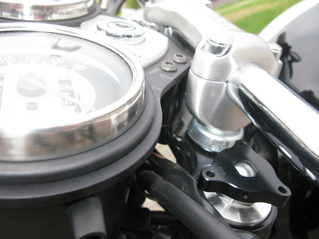

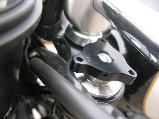

Figured some new pics would be nice. Bob
