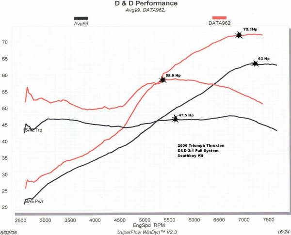

Verry interesting thread guys!.. I always suspected the crossover pipe was just there to split the flow between the two mufflers for EPA noise control. But it probably reduces overall backpressure during high rpm operation(i.e., full throttle max HP)
I see that D&D publishes a Dyno chart showing their 2 into one header vs. a stock Thruxton (see below)
They are showing 63 hp as a baseline for their jetted bike, and 72 hp with their 2 into 1 header. If it's true, then the scavenging effect (#1 cylinder pulse creating a suction in the collector as it passes thru just in time to pull the gas from cylinder #2) has a huge effect on power! The OEM balance pipe helps some over 'TT-style' individual head pipes, by reducing exhaust backpressure...no real scavenging like a 2 into one.
I would like to see someone make a more traditional 2 into 1 into two header for the Thruxton that you could mount stock or aftermarket pipes to. I just like the 'traditional' look of two tapered reverse cone pipes. Twin mufflers also help to keep the sound level low without resorting to a giant single canister like the Zard. I made up a quickie drawing of my concept in AutoCad just to get my idea across, and it's posted below:
I did a quick search and didn't see anything like it as being available for the Thruxton. Has anyone seen such an animal? I would be willing to build one to try, although it would probably eliminate my center-stand. I would also make it a 'big-tube' header...1.75" (45mm) pipes to flow some real gas.
Any comments?

Well, you have a motivated buyer here, if you'd like me to somehow commission the build. i would certainly be able to provide the "after' dyno run with consistent variables. Finding used headers is going to be a bit*h.

yea Thruxton headers new are high if you cant find some used you would be better off going to D&D 2INTO 1 and selling your new mufflers you have.You need Thruxton headers they are better then bonnie headers because of there shape.I have a set of bonnie headers i will sell but dont think they would help you much.Maybe you could try some of the bike junk yards.
