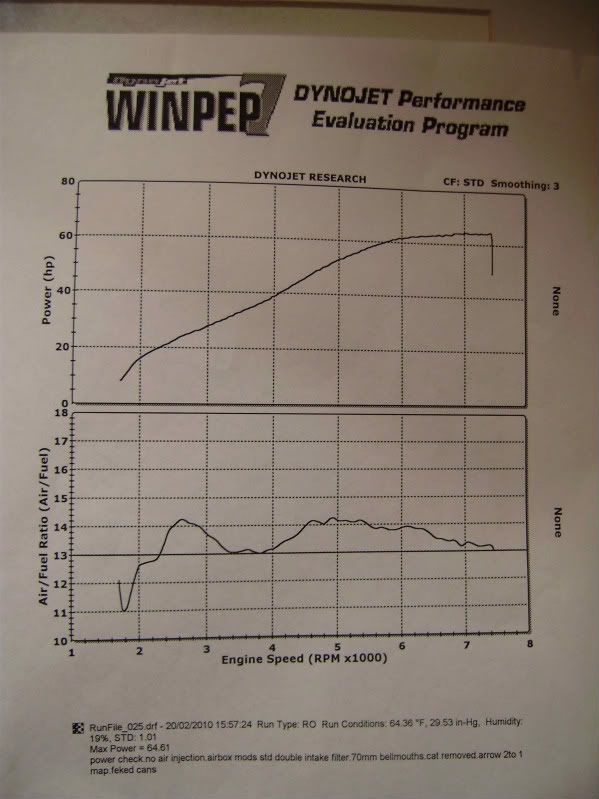

I took my bike up to be dyno'd today, just to see where I was with the feked pipes compared to the tors. The only things different from the last tors run, was that I used an open ended Triumph paper filter instead of the Unifilter (I had to cut up the Unifilter to make a new filter for my Beamish)
I'm sorry about the poor quality of the charts, the printer at the dyno room only worked in b/w today, then my scanner went for a sh!te, so I had to take photies of the charts instead:
It shows the feked pipes make a bit more power and torque than the tors, no great surprise there, but my fuelling with the Arrow 2/1 map is now a bit on the weak side (was a bit rich with the tors from 6,000 up) I can't really do much about this with the Triumph maps available (wish I had carbs) and Willie the dyno guy (who sells, fits and sets up power commanders) said it wasn't really worth the extra £500 or so to flatten the bumps with a pc111. I'm delighted with the way the bike goes, the 19t is going back on tomorrow, but if anything the seat of the pants feel is that she's really getting a move-on where the a/f is at 14, then spins right through to the red.
here's the previous dyno run with tors, for comparison:
