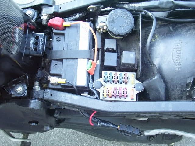

I ended up doing a charging system modification that I did on my Speedtona (thanks to a post over in the Daytona forum). I soldered a 12 gauge red wire through the 2 output wires of the regulator (connecting the two), through an in-line fuse, and directly to the positive battery terminal. I then soldered a 12 gauge black wire to the output ground of the regulator and ran it to the negative battery terminal. The difference is amazing. Before the mod, the system was charging at 14.5V at idle (190*F), and once the throttle was opened it dropped to 14.2V. After the mod, it charges at 14.87V at idle (190*F) and drops to 14.7V when the throttle is opened. Now the charging system is working properly.
