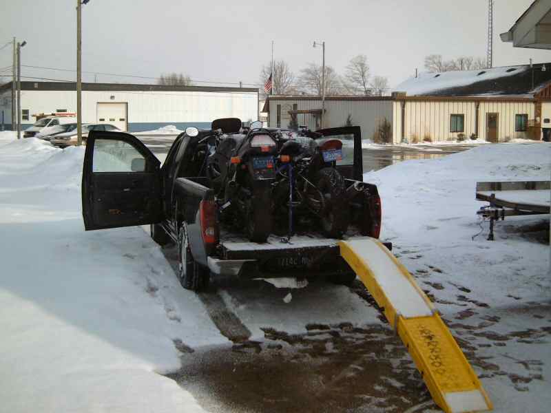

Originally Posted by glok22 View Post
I'd love to see this thread in pictures. As it's always interesting to see how people transport their bikes. One track day I observed a guy hauling his sportbike inside a minivan. I have no idea how he got in or out. I have an S-10 with the ZR-2 package and I use two buddies and a ramp to push it up into the truck bed. Then, I have someone sit on it and balance it so I can use the tie downs. There needs to be an affordable, double wide, and foldable ramp to make the loading of bikes a little bit easier, into the beds of trucks that sit higher off the ground!
A guy I work with has a Dodge Sprinter that he hauls around his bikes inside of.
Picking up my buddy's 600 Kat:
[img]
My 750 and his 600, and the ramp I have:
Those are before the lift...don't think I have any pics from after with a bike in it, I've only hauled a bike once since installing the lift, and it was that 750, which I'd sold to a buddy....man was it a pain to get that thing up there...
