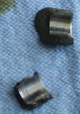

Angry Possible major flaw in Triumph twins - Starter shaft race castings broken!
2005 Speedmaster - 7000 miles
went to start it a few days ago and after two turns of the crank... a loud clunk and then.....
The starter shaft races had both broken and the starter gear was wedged against the engine case:
more pics in next post

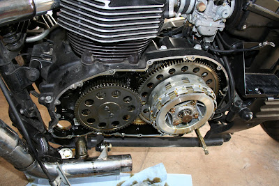

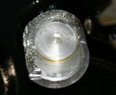

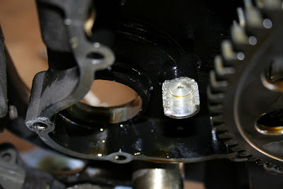

I believe this is the same problem Lorenzo describes in this thread:
http://www.triumphrat.net/modificati...ar-wedged.html
anyone else have, or know others with, this problem?
A few more pics:
