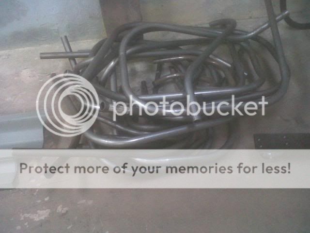

bin reading and looking a lot on this great forum so now its time to start..this is going to be a total build so it will take awhile...so here i go...started with a loaner atlas thinline to make my form jigs...the guy was really cool letting me keep it for a week( i actually don't think it was his to loan but great guy anyway) ..so last night i finally got the first side bent after a day of scrape....any info or suggestions along this long road please chime
in... thanx...billy

well the metal was flyin today! got the other side of the thinline done and figured i would bend up some 4130 for a wideline..
can't do that rear kink in the 4130 so wideline it is for that material..here are the pics

well its bin a hell of a long couple weeks on this frame from making check jigs to all kinds of measuring to cad ...but! i end today with 3 good frames! oh yea and this!
lots of scrap for the straight pieces !
